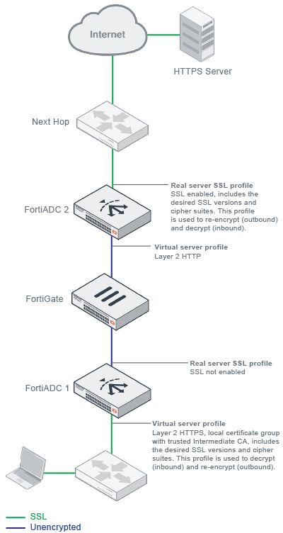

The call-outs in Layer 2 sandwich profiles have guidance for the two types of profiles used in a Layer 2 sandwich deployment.
In this deployment, the FortiADC 1 virtual server is of a Layer-2 HTTPS virtual server configuration. Its client SSL profile supports SSL forward proxy, including the special local signing CA. For Layer-2 virtual servers, the "real server" target is the next hop. In this case, the real server target is the FortiGate pool. Because SSL is not enabled in the real server SSL profile, FortiADC 1 does not re-encrypt the SSL connection. (However, you can configure allowed SSL versions and ciphers in the client SSL profile, and you can also configure an SSL certificate verification policy to enforce rules and checks on the destination server certificate.) The client SSL profile settings are used when re-encrypting the server response traffic in the return segment to the client.
The FortiADC 2 virtual server is a Layer 2 HTTP virtual server configuration. It receives unencrypted traffic from FortiGate. Its server pool is the next hop gateway. On its server side, FortiADC uses the real server SSL profile settings when it encrypts the outbound SSL connection and decrypts the inbound response traffic.
