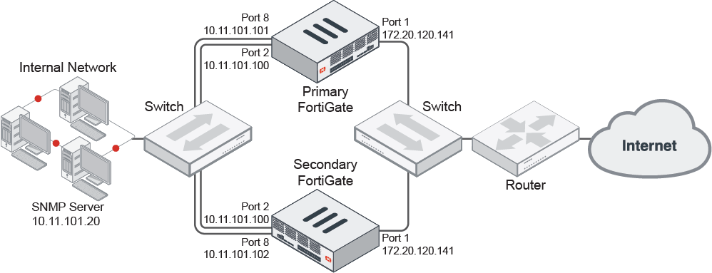

Configuring SNMP remote management of individual cluster units example
In this example, two FortiGate units are already operating in a cluster. On each unit, port8 is connected to the internal network through a switch and configured as a reserved management interface with SNMP remote management.
Configuration changes to the reserved management interface are not synchronized to other cluster units.

SNMP management
The SNMP server can get status information from the cluster members. To use the reserved management interfaces, you must add at least one HA direct management host to an SNMP community. If the SNMP configuration includes SNMP users with user names and passwords, HA direct management must be enabled for the users.
To configure the cluster for SNMP management using the reserved management interfaces in the CLI:
  1. Add an SNMP community with a host for the reserved management interface of each cluster member. The host includes the IP address of the SNMP server.

  1. From a computer on the internal network, connect to the primary unit's CLI.
  2. Connect to the secondary unit with the following command:
    execute ha manage <unit id> <username> <password>
  3. Change the port8 IP address and management access:
    config system interface
        edit port8
            set ip 10.11.101.102/24
            set allowaccess https ping ssh snmp
    exit
    You can now log into the secondary unit's GUI by browsing to https://10.11.101.102. You can also log into the secondary unit's CLI by using an SSH client to connect to 10.11.101.102.
SNMP management
    config system snmp community
            set name "Community"
            config hosts
                    set ip 10.11.101.20 255.255.255.255
                    set ha-direct enable
    Enabling ha-direct in a non-HA environment will make SNMP unusable.
  2. Add an SNMP user for the reserved management interface
    config system snmp user
        edit "1"
            set notify-hosts 10.11.101.20
The SNMP configuration is synchronized to all cluster units.
To get CPU, memory, and network usage information from the SNMP manager for each cluster unit using the reserved management IP addresses:
  1. Connect to the SNMP manager CLI.
  2. Get resource usage information for the primary unit using the MIB fields:
    snmpget -v2c -c Community 10.11.101.101 fgHaStatsCpuUsage
    snmpget -v2c -c Community 10.11.101.101 fgHaStatsMemUsage
    snmpget -v2c -c Community 10.11.101.101 fgHaStatsNetUsage
  3. Get resource usage information for the primary unit using the OIDs:
    snmpget -v2c -c Community 10.11.101.101 1.3.6.1.4.1.12356.101.13.2.1.1.3.1
    snmpget -v2c -c Community 10.11.101.101 1.3.6.1.4.1.12356.101.13.2.1.1.4.1
    snmpget -v2c -c Community 10.11.101.101 1.3.6.1.4.1.12356.101.13.2.1.1.5.1
  4. Get resource usage information for the secondary unit using the MIB fields:
    snmpget -v2c -c Community 10.11.101.102 fgHaStatsCpuUsage
    snmpget -v2c -c Community 10.11.101.102 fgHaStatsMemUsage
    snmpget -v2c -c Community 10.11.101.102 fgHaStatsNetUsage
  5. Get resource usage information for the primary unit using the OIDs:
    snmpget -v2c -c Community 10.11.101.102 1.3.6.1.4.1.12356.101.13.2.1.1.3.1
    snmpget -v2c -c Community 10.11.101.102 1.3.6.1.4.1.12356.101.13.2.1.1.4.1
    snmpget -v2c -c Community 10.11.101.102 1.3.6.1.4.1.12356.101.13.2.1.1.5.1
