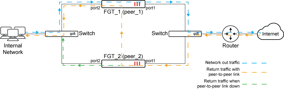

In the following configurations, two peers are configured in FGSP. Two routing prefixes are monitored. In the diagram below, traffic travels asymmetrically, but is eventually bounced back to the peer (FGT_1) where the traffic was initiated. This allows the traffic to continue its UTM inspection through the peer.
In the scenario that one of the peers (FGT_1) no longer sees a route to a prefix, disrupting the flow of traffic, instead of causing network isolation and blackholing by bouncing the traffic back to the peer (FGT_1), traffic instead continues through the healthy peer (FGT_2).
Note that in this case, traffic does not get scanned by UTM on the healthy peer (FGT_2).

    4. Traffic originally passes through UTM inspection over peer_1. The return traffic is routed to peer_2, where it will bounce to peer_1, the original FGSP peer for inspection.

    8. Upon peer_1 becoming unavailable or unhealthy, traffic no longer bounces back to peer_1. Instead, it is failed over to peer_2 for processing.
