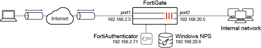

Sample topology
Sample configurations
Configure a Primary and Secondary server for backup
When you define a Primary and Secondary RADIUS server, the access request will always be sent to the Primary server first. If the request is denied with an Access-Reject, then the user authentication fails. However, if there is no response from the Primary server after another attempt, the access request will be sent to the Secondary server.
In this example, you will use a Windows NPS server as the Primary server and a FortiAuthenticator as the Secondary server. It is assumed that users are synchronized between the two servers.

To verify the connection:
User radkeith is a member of both the NPS server and the FAC server.
When the Primary server is up, it will connect to the SSL VPN tunnel using FortiClient.
# diagnose sniffer packet any 'port 1812' 4 0 l
interfaces=[any]
filters=[port 1812]
2020-05-15 16:26:50.838453 port3 out 192.168.20.5.2374 -> 192.168.20.6.1812: udp 118
2020-05-15 16:26:50.883166 port3 in 192.168.20.6.1812 -> 192.168.20.5.2374: udp 20
2020-05-15 16:26:50.883374 port3 out 192.168.20.5.2374 -> 192.168.20.6.1812: udp 182
2020-05-15 16:26:50.884683 port3 in 192.168.20.6.1812 -> 192.168.20.5.2374: udp 228
The access request is sent to the Primary NPS server 192.168.20.6, and the connection is successful.

When the Primary server is down, and the Secondary server is up, the connection is made to the SSLVPN tunnel again:
interfaces=[any]
filters=[port 1812]
2020-05-15 16:31:23.016875 port3 out 192.168.20.5.7989 -> 192.168.20.6.1812: udp 118
2020-05-15 16:31:28.019470 port3 out 192.168.20.5.7989 -> 192.168.20.6.1812: udp 118
2020-05-15 16:31:30.011874 port1 out 192.168.2.5.23848 -> 192.168.2.71.1812: udp 118
2020-05-15 16:31:30.087564 port1 in 192.168.2.71.1812 -> 192.168.2.5.23848: udp 20
Access request is sent to the Primary NPS server 192.168.20.6, but there was no response. RADIUS authentication falls through to the Secondary FortiAuthenticator 192.168.2.71, and the authentication was accepted. The VPN connection is established.

When configuring two or more RADIUS servers, you can configure a Primary and Secondary server within the same RADIUS server configurations for backup purposes. You can also configure multiple RADIUS servers within the same User Group to service the access request at the same time.
Tooltip
A tertiary server can be configured in the CLI.
Sample topology

To configure SSL VPN using the CLI:
  1. Configure the internal interface and firewall address:
    config system interface
    edit "port3"
    set vdom "root"
    set ip 192.168.20.5 255.255.255.0
    set alias "internal"
    config firewall address
    edit "192.168.20.0"
    set uuid cc41eec2-9645-51ea-d481-5c5317f865d0
    set subnet 192.168.20.0 255.255.255.0
  2. Configure the RADIUS server:
    config user radius
    edit "win2k16"
    set server "192.168.20.6"
    set secret <secret>
    edit "fac"
    set server "192.168.2.71"
    set secret <secret>
  3. Add the RADIUS user to the user group:
    config user group
    edit "dualPrimaryGroup"
    set member "win2k16" “fac”
  4. Configure SSL VPN settings:
    config vpn ssl settings
    set servercert "server_certificate"
    set tunnel-ip-pools "SSLVPN_TUNNEL_ADDR1"
    set source-interface "port1"
    set source-address "all"
    set default-portal "web-access"
    config authentication-rule
    set groups "dualPrimaryGroup"
    set portal "full-access"
  5. Configure one SSL VPN firewall policy to allow remote users to access the internal network:
    config firewall policy
    set name "sslvpn-radius"
    set srcintf "ssl.root"
    set dstintf "port3"
    set srcaddr "all"
    set dstaddr "192.168.20.0"
    set groups “dualPrimaryGroup”
    set service "ALL"
    set nat enable
    User fackeith is a member of the FortiAuthenticator server only.
    User radkeith is a member of both the NPS server and the FortiAuthenticator server, but has different passwords on each server.
    Case 1: Connect to the SSLVPN tunnel using FortiClient with user FacAdmin:
    interfaces=[any]
    filters=[port 1812]
    2020-05-15 17:21:31.217985 port3 out 192.168.20.5.11490 -> 192.168.20.6.1812: udp 118
    2020-05-15 17:21:31.218091 port1 out 192.168.2.5.11490 -> 192.168.2.71.1812: udp 118
    2020-05-15 17:21:31.219314 port3 in 192.168.20.6.1812 -> 192.168.20.5.11490: udp 20 <-- access-reject
    2020-05-15 17:21:31.219519 port3 out 192.168.20.5.11490 -> 192.168.20.6.1812: udp 182
    2020-05-15 17:21:31.220219 port3 in 192.168.20.6.1812 -> 192.168.20.5.11490: udp 42
    2020-05-15 17:21:31.220325 port3 out 192.168.20.5.11490 -> 192.168.20.6.1812: udp 119
    2020-05-15 17:21:31.220801 port3 in 192.168.20.6.1812 -> 192.168.20.5.11490: udp 20
    2020-05-15 17:21:31.236009 port1 in 192.168.2.71.1812 -> 192.168.2.5.11490: udp 20 <--access-accept
    Access is denied by the NPS server because the user does not exist. However, access is accepted by FortiAuthenticator. The end result is the authentication is successful.
    # get vpn ssl monitor
    SSL VPN Login Users:
    Index   User       Group             Auth Type      Timeout         From       HTTP in/out    HTTPS in/out
    0       fackeith  dualPrimaryGroup   2(1)            292        192.168.2.202      0/0         0/0
    SSL VPN sessions:
    Index   User       Group                  Source IP      Duration        I/O Bytes       Tunnel/Dest IP
    0       fackeith  dualPrimaryGroup        192.168.2.202   149              70236/4966     10.212.134.200
    Case 2: Connect to the SSLVPN tunnel using FortiClient with user radkeith:
    interfaces=[any]
    filters=[port 1812]
    2020-05-15 17:26:07.335791 port1 out 192.168.2.5.17988 -> 192.168.2.71.1812: udp 118
    2020-05-15 17:26:07.335911 port3 out 192.168.20.5.17988 -> 192.168.20.6.1812: udp 118
    2020-05-15 17:26:07.337659 port3 in 192.168.20.6.1812 -> 192.168.20.5.17988: udp 20 <--access-accept
    2020-05-15 17:26:07.337914 port3 out 192.168.20.5.17988 -> 192.168.20.6.1812: udp 182
    2020-05-15 17:26:07.339451 port3 in 192.168.20.6.1812 -> 192.168.20.5.17988: udp 228
    2020-05-15 17:26:08.352597 port1 in 192.168.2.71.1812 -> 192.168.2.5.17988: udp 20 <--access-reject
    There is a password mismatch for this user on the Secondary RADIUS server. However, even though the authentication was rejected by FortiAuthenticator, it was accepted by Windows NPS. Therefore, the end result is authentication successful.
    0       radkeith  dualPrimaryGroup   2(1)            290        192.168.2.202    0/0           0/0
    SSL VPN sessions:
    0       radkeith dualPrimaryGroup   192.168.2.202   142              64875/4966     10.212.134.200
