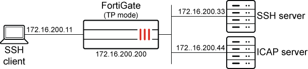

Example
The FortiGate used in this example is operating in transparent mode. The SSH client, 172.16.200.11, sends a file named today to the SSH server at 172.16.200.33 using SCP. Since SCP transfers are encrypted inside an SSH tunnel, for the FortiGate to scan the traffic, deep inspection must be enabled in the SSL SSH profile.

ICAP scanning with SCP and FTP
A FortiGate can forward files transferred by SCP and FTP to an ICAP server for further scanning. Previously, only HTTP and HTTPS were supported for ICAP forwarding.
Example
