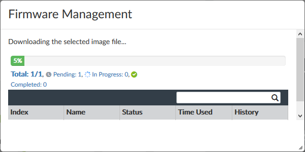

To update FortiManager firmware using FortiGuard:
  1. Go to System Settings.
  2. In the System Information widget, beside Firmware Version, click Update Firmware.
    The Firmware Management dialog box opens.
  3. From the FortiGuard Firmware box, select the version of FortiManager for the upgrade, and click OK.
    The FortiGuard Firmware box displays all FortiManager firmware images available for upgrade. A green checkmark displays beside the recommended image for FortiManager upgrade.
    If you select an image without a green checkmark, a confirmation dialog box is displayed. Click OK to continue.
    FortiManager downloads the firmware image from FortiGuard.
    FortiManager uses the downloaded image to update its firmware, and then restarts.
    After FortiManager restarts, the upgrade is complete.
