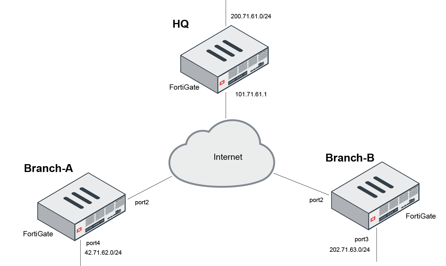

The following example assumes that site HQ IPsec VPN has been configured and is up and running. We will establish the configurations of Branch-A and Branch-B sites to the HQ site by using an IPsec template.

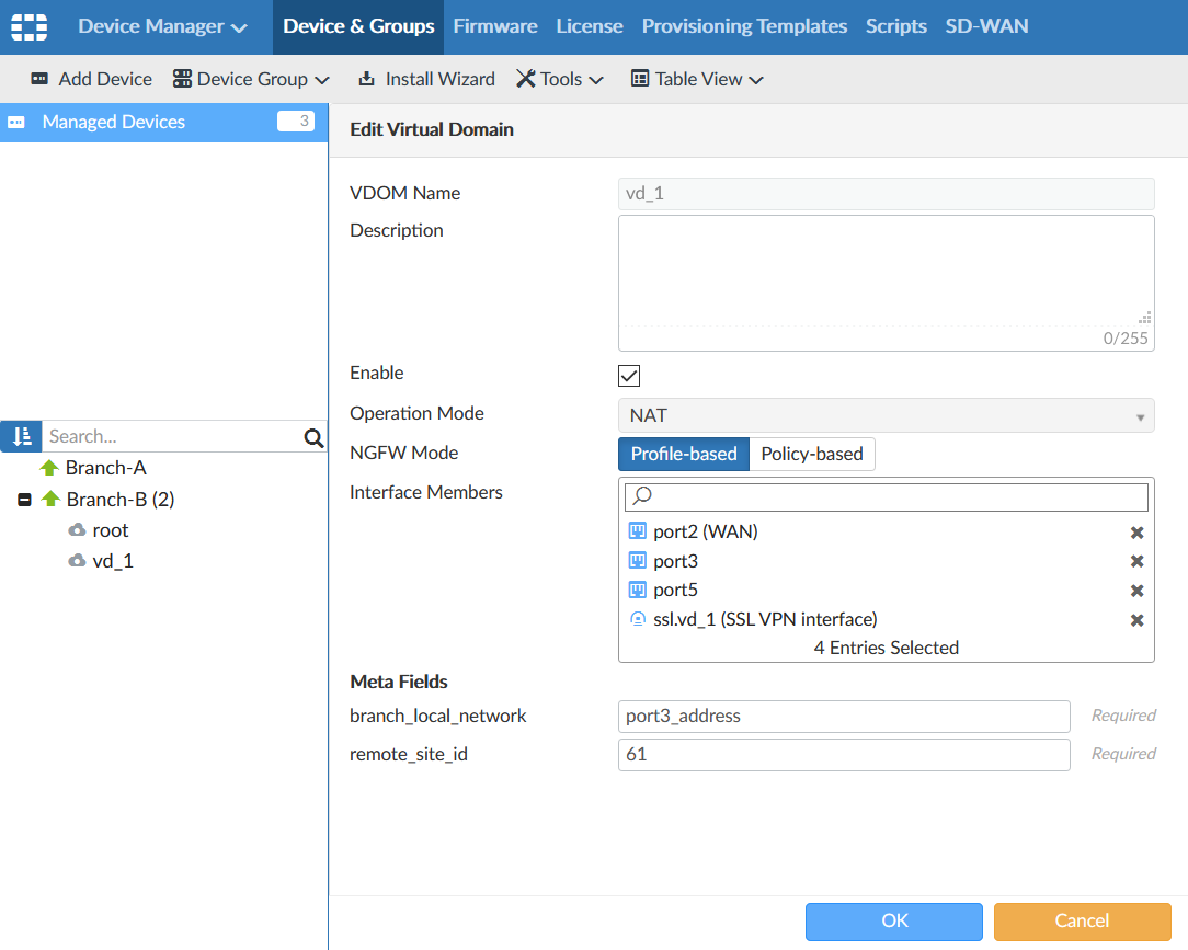

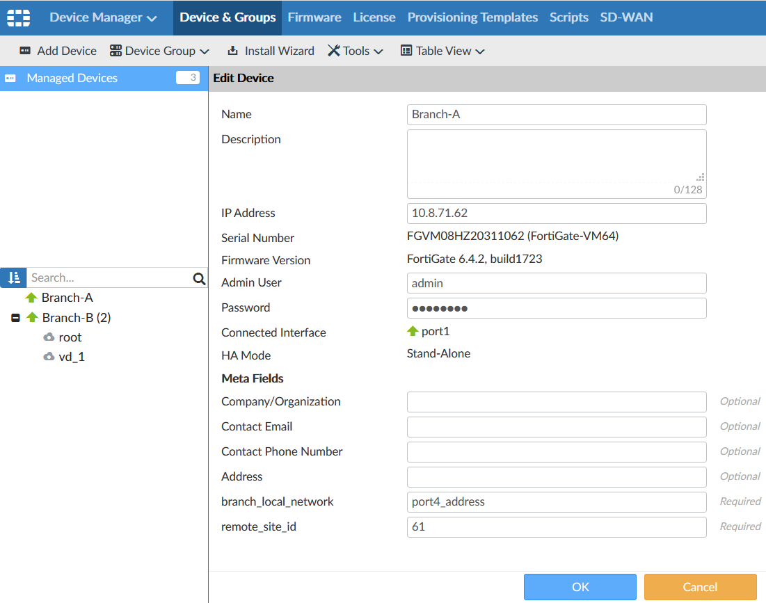

Once meta fields are created, you need to assign values to the meta field variables for each device. You will assign values to the meta field variables branch_local_network and remote_site_id for both the sites Branch-A and Branch-B.
To assign a value to a meta field variable for a device:
- Go to Device Manager > Device & Groups > Managed Devices.
- Select device Branch-A and click Edit. The Edit Device pane appears.
- Scroll down to the Meta Fields section and add values for both the branch_local_network and remote_site_id fields.
- Click OK.
Similarly, edit device Branch-B to add values to the meta field variables.

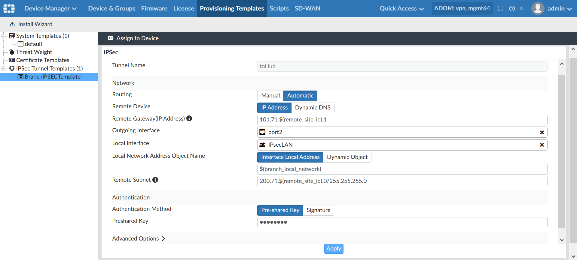

- Click on the template name from the tree menu at the left. The IPsec settings for the template appear on screen:
Setting
Value/Description
Tunnel Name
Name of the IPsec tunnel.
Routing
Automatic: Static routes to remote subnet will be created.
Remote Device
IP Address
Remote Gateway (IP Address)
This field accepts meta field variables and you will use the remote_site_id meta field variable here, for example,
101.71.$(remote_site_id).1, where the meta field variable value will be substituted at runtime.Outgoing Interface
port2Local Interface
We need to create and select a normalized interface with per-device mapping as different devices use different local interfaces. In this case, it is IPsecLAN.
Local Network Address Object Name
Select Interface Local Address, and enter the meta field variable
$(branch_local_network), where the meta field variable value will be substituted at runtime.Remote Subnet
Enter
200.71.$(remote_site_id).0/255.255.255.0, where the meta field variable value will be substituted at runtime.Authentication Method
Pre-shared Key: Alphanumeric key used for device authentication.
- Click Apply at the bottom to save the settings. The IPsec template is created and is ready to be assigned to devices.

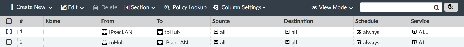

- Go to Policy & Objects > Policy Packages > Firewall Policy.
- Click Create New from the toolbar. The Create New Firewall Policy pane appears.
- Create two firewall policies for traffic between the normalized interface and HQ site.

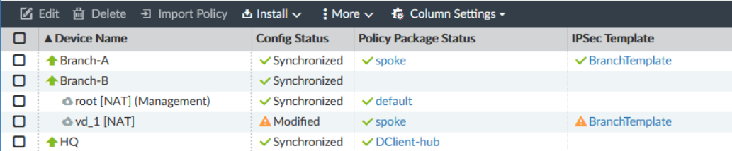

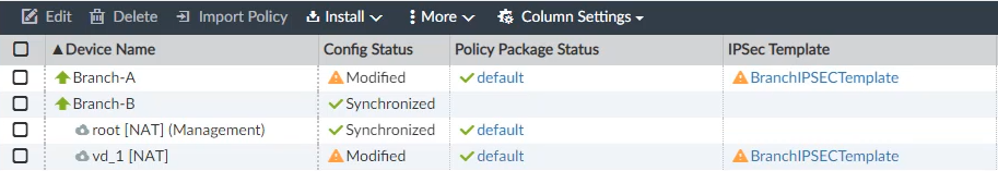

Verifying IPsec template configuration status
To verify IPsec template configuration status:
- Click Column Settings from the toolbar and select IPsec Template. The IPsec Template column appears in the table.
A device with a synchronized template status would be indicated by a green tick mark icon before the template name in the IPsec Template column, while a device with a modified status would be indicated by a yellow triangle caution icon.
