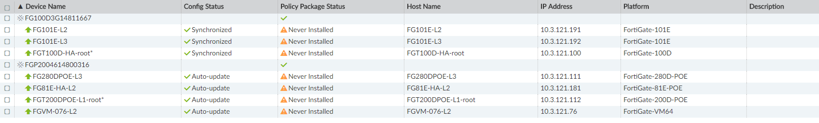

The entire Security Fabric group with all the devices are added to FortiManager. FortiGate devices are listed under Managed Devices.
If the FortiManager is behind NAT, adding the root FortiGate will not add all the members of the Security Fabric Group automatically. If the FortiManager is behind NAT, the only way is to add each member of the Security Fabric group manually. |
Refresh the Security Fabric root after all the members of the group are added to FortiManager. FortiManager retrieves information about the Security Fabric group via the root FortiGate unit. All units are displayed in a Security Fabric group. The Security Fabric icon identifies the group, and the group name is the serial number for the root FortiGate in the group. Within the group, a * at the end of the device name identifies the root FortiGate in the group.
