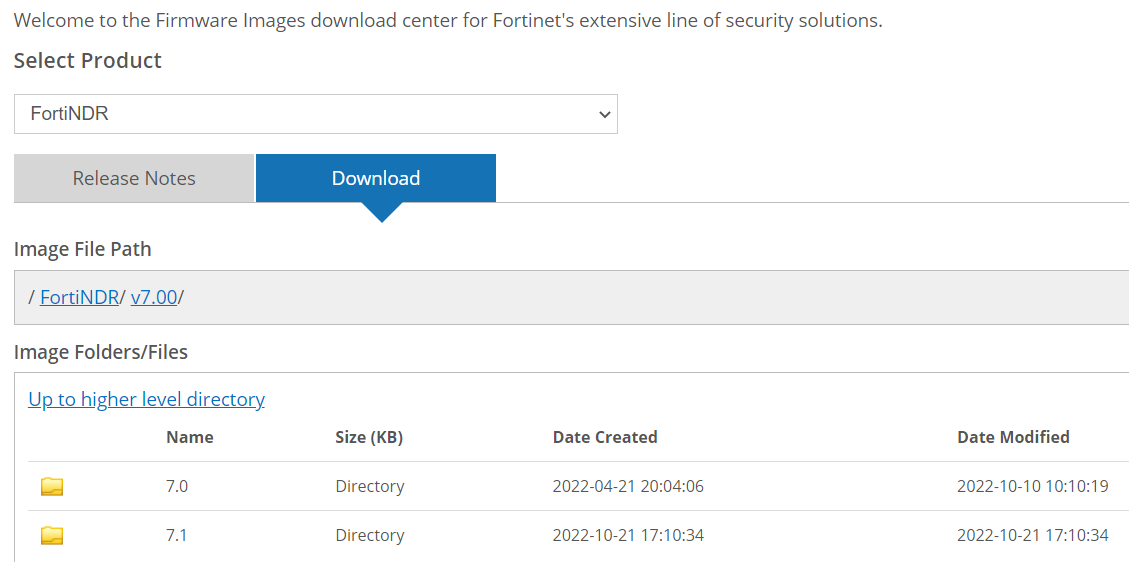

To download the latest version of FortiNDR:
  1. Log into FortiCloud.

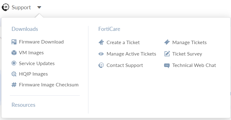

  2. In the banner, click Support > Firmware Download.
  3. From the Select Product dropdown, select FortiNDR.
  4. Click the Download tab.
  5. Use the folders in the directly to locate and download the latest firmware version.

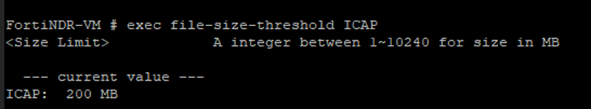

The File size limit can be found hitting tab key in the following CLI:
execute file-size-threshold {ICAP|OFTP|inline-blocking|manual-upload|network-share|sniffer} <size_limit_1-10240MB>
Please make a note for each file input value.
