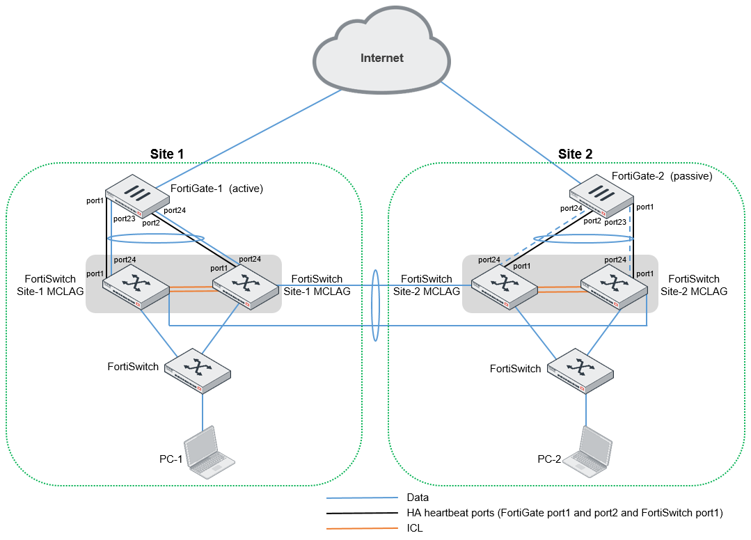

HA-mode FortiGate units in different sites
There are two sites in this topology, each with a FortiGate unit. The two sites share the FortiGate units in active-passive HA mode. The FortiGate units use the FortiSwitch units in FortiLink mode as the heartbeat connections because of limited physical connections between the two sites.
FortiOS 6.4.2 or higher and FortiSwitchOS 6.4.2 or higher are required.
For example steps, refer to Deploying MCLAG topologies.
NOTE: Fortinet recommends using at least two links for ICL redundancy.

Starting with FortiOS 6.4.2, you can use the GUI to entirely manage multiple FortiLink stacks.
Three-tier FortiLink MCLAG configuration
To create a three-tier FortiLink MCLAG topology, use FortiOS 6.2.3 GA or later and FortiSwitchOS 6.2.3 GA or later.
MCLAG can be deployed in up to three tiers to expand the FortiSwitch stack, offering link and switch redundancy with the efficient use of the bandwidth because all links are active.
For the procedure, see Deploying MCLAG topologies.
Dual-homed servers connected to a pair of FortiSwitch units using an MCLAG
To configure a multichassis LAG, you need to configure FortiSwitch 1 and FortiSwitch 2 as MCLAG peer switches before creating a two-port LAG. Then you set up two MCLAGs towards the servers, each MCLAG using one port from each FortiSwitch unit. For the procedure, see Deploying MCLAG topologies.
This topology is supported when the FortiGate unit is in HA mode.
NOTE:
  • On the global switch level, mclag-stp-aware must be enabled, and STP must be enabled on all ICL trunks. They are both enabled by default.
  • Fortinet recommends using at least two links for ICL redundancy.
NOTE: If you are going to use IGMP snooping with an MCLAG topology:
  • On the global switch level, mclag-igmpsnooping-aware must be enabled. It is enabled by default.
  • The igmps-flood-traffic and igmps-flood-report settings must be disabled on the ISL and FortiLink trunks; but the igmps-flood-traffic and igmps-flood-report settings must be enabled on ICL trunks. These settings are enabled by default.
  • IGMP proxy must be enabled.
