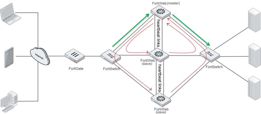

This is an example for an active-active HA network topology in Reverse Proxy mode:
A FortiWeb active-active HA cluster can be consist of up to eight FortiWebs. All the cluster members operate as an active appliance together, which means each of the members can simultaneously handle the traffic between clients and the back web servers. In an active-active HA cluster, there is one appliance selected as the master and the others are slaves. Like a central controller, only the master appliance receives traffic from clients and web servers; it will distribute received traffic to the cluster members (including itself), so that each FortiWeb appliance performs the security services to monitor traffic.
Similar to the active-passive HA deployment, the operation of active-active HA cluster requires heartbeat detection, configuration and session synchronization between the cluster members. If the master appliance fails, one of the slaves will take it over. The heartbeat interfaces of all the HA appliances must be connected directly with crossover cables or through switches to carry the heartbeat and synchronization traffic between the HA cluster members.
