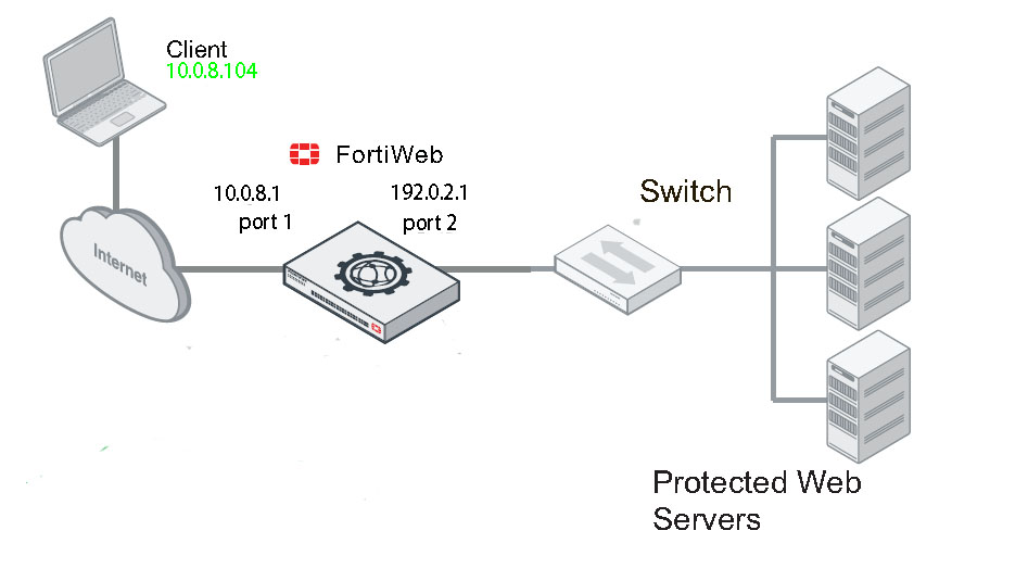

  1. Run commands similar to the following to capture the flow from the client (for example, host 10.0.8.104), and activate the debug flow required:
  2. FortiWeb # diagnose debug trace tcpdump filter "host 10.0.8.104"
    FortiWeb # diagnose debug trace tcpdump interface port1
    FortiWeb # diagnose debug flow filter client-ip 10.0.8.104
    FortiWeb # diagnose debug flow filter flow-detail 7
    FortiWeb # diagnose debug trace report start
  3. Initiate HTTP request from this client (10.0.8.104) to the virtual server.
  4. Stop collecting the information with the command below after some time:
  5. FortiWeb # diagnose debug trace report stop
  6. Download debug logs from System > Maintenance > Debug > Download .
