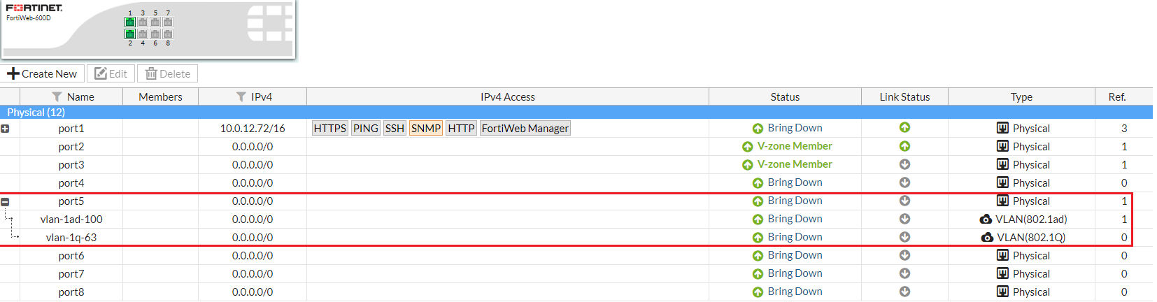

Adding VLAN subinterfaces
You can add a virtual local area network (VLAN) subinterface to a network interface or bridge on the FortiWeb appliance, up to a maximum of 512 VLAN in total.
Similar to a local area network (LAN), use a IEEE 802.1q (http://www.ieee802.org/1/pages/802.1Q.html) VLAN to reduce the size of a broadcast domain and thereby reduce the amount of broadcast traffic received by network hosts, improving network performance.
In True Transparent Proxy mode, to expand the VLAN space, Q-in-Q is introduced for FortiWeb to stack 802.1Q and 802.1ad (http://www.ieee802.org/1/pages/802.1Q.html) headers in the Ethernet frame, so that multiple VLANs are reused in a core VLAN. The 802.1Q VLAN (Ethernet Type = 0x8100) can be packed into the 802.1ad VLAN (Ethernet Type = 0x88A8). If you create a 802.1ad VLAN per a physical interface, then you can create a 802.1Q VLAN per 802.1ad VLAN. Packets will be tagged by two VLANs.
VLANs are not designed to be a security measure, and should not be used where untrusted devices and/or individuals outside of your organization have access to the equipment. VLAN tags are not authenticated, and can be ignored or modified by attackers. VLAN tags rely on the voluntary compliance of the receiving host or switch.
Unlike physical LANs, VLANs do not require you to install separate hardware switches and routers to achieve this effect. Instead, VLAN-compliant switches, such as FortiWeb appliances, restrict broadcast traffic based upon whether its VLAN ID matches that of the destination network. As such, VLAN trunks can be used to join physically distant broadcast domains as if they were close.
The VLAN ID is part of the tag that is inserted into each Ethernet frame in order to identify traffic for a specific VLAN. VLAN header addition is handled automatically by FortiWeb appliances, and does not require that you adjust the maximum transmission unit (MTU). Depending on whether the device receiving a packet operates at Layer 2 or Layer 3 of the network, this tag may be added, removed, or rewritten before forwarding to other nodes on the network.
Cisco Discovery Protocol (CDP) is supported for VLANs, including when FortiWeb is operating in either of the transparent modes.
If your FortiWeb model uses Data Plane Development Kit (DPDK) for packet processing (for example, models 3000E, 3010E and 4000E), you cannot use VLAN subinterfaces as a data capture port for Offline Protection mode. For these models, remove any VLAN configuration on an interface before you use it for data capture. These models fully support the capture and transmission of VLAN traffic.
To configure a VLAN subinterface
  1. Go to System > Network > Interface.
    To access this part of the web UI, your administrator's account access profile must have Read and Write permission to items in the Network Configuration category. For details, see Permissions.
  2. Click Create New.
  3. Configure these settings:
  4. Name Type the name (for example, vlan100) of this VLAN subinterface that can be referenced by other parts of the configuration. The maximum length is 15 characters.
    Tip: The name cannot be changed once you save the entry. For a workaround, see Renaming entries.
    Type Select VLAN.
    Interface Select the name of the physical network port with which the VLAN subinterface will be associated.
    VLAN ID
    Type the VLAN ID , such as 100, of packets that belong to this VLAN subinterface.
    • If one physical network port (that is, a VLAN trunk) will handle multiple VLANs, create multiple VLAN subinterfaces on that port, one for each VLAN ID that will be received.
    • If multiple different physical network ports will handle the same VLANs, on each of the ports, create VLAN subinterfaces that have the same VLAN IDs.
    The valid range is between 1 and 4094 and must match the VLAN ID added by the IEEE 802.1q-compliant router or switch connected to the VLAN subinterface.
    For the maximum number of interfaces for your FortiWeb model, including VLAN subinterfaces, see Appendix B: Maximum configuration values.
    VLAN Protocol Select a VLAN type 802.1Q or 802.1ad.
    Addressing Mode Specify whether FortiWeb acquires an IPv4/IPv6 address for this VLAN using DHCP.
    IP/Netmask Type the IP address/subnet mask associated with the VLAN, if any. The IP address must be on the same subnet as the network to which the interface connects. Two network interfaces cannot have IP addresses on the same subnet.
    Administrative Access Enable the types of administrative access that you want to permit to this interface.
    These options do not disable outgoing administrative connections, such as update polling connections to the FDN or outgoing ICMP resulting from a CLI command such as execute ping. Neither do they govern traffic destined for a web server or virtual server, which are governed by policies. These options only govern incoming connections destined for the appliance itself.
    Caution: Enable only on network interfaces connected to trusted private networks (defined in Trusted Host #1, Trusted Host #2, Trusted Host #3) or directly to your management computer. If possible, enable only secure administrative access protocols such as HTTPS or SSH. Failure to restrict administrative access could compromise the security of your FortiWeb appliance.
      HTTPS Enable to allow secure HTTPS connections to the web UI through this network interface. To configure the listening port number, see Global web UI & CLI settings.
      PING Enable to allow:
    • ICMP type 8 (ECHO_REQUEST)
    • UDP ports 33434 to 33534
    for ping and traceroute to be received on this network interface. When it receives an ECHO_REQUEST (“ping”), FortiWeb will reply with ICMP type 0 (ECHO_RESPONSE or “pong”).
    Note: Disabling PING only prevents FortiWeb from receiving ICMP type 8 (ECHO_REQUEST) and traceroute-related UDP.
    It does not disable FortiWeb CLI commands such as execute ping or execute traceroute that send such traffic.
      HTTP
    Enable to allow HTTP connections to the web UI through this network interface. To configure the listening port number, see Global web UI & CLI settings.
    The HTTP access to FortiWeb's GUI will be automatically redirected to HTTPS, so you can't enable HTTP alone, it should be enabled along with HTTPS.
      SSH Enable to allow SSH connections to the CLI through this network interface.
      SNMP Enable to allow SNMP queries to this network interface, if queries have been configured and the sender is a configured SNMP manager. To configure the listening port number and configure queries and traps, see SNMP traps & queries.
      FortiWeb Manager Enable to allow FortiWeb Manager to connect to this appliance using this network interface.
    WCCP Protocol Select if the interface is used to communicate with a FortiGate unit configured as a WCCP server.
    Available only when the operation mode is WCCP.
    For details, see Setting the operation mode and Configuring FortiWeb to receive traffic via WCCP.
  5. Click OK.
  6. Your new VLAN is initially hidden in the list of network interfaces.
    To expand the network interface listing in order to view all of a port’s associated VLANs, click the + (plus sign) beside the name of the port.

    Since FortiWeb 6.1 release, vlan subinterfaces including 802.1Q, 802.1ad and physical interfaces can be configured in one V-zone.
    Note: Only network interfaces with no IP address can belong to a bridge. port1 is reserved for your management computer, and cannot be bridged. To remove any other network interface’s IP address so that it can be included in the bridge, set its IP/Netmask to 0.0.0.0/0.0.0.0.
      Type Select VLAN.
      VLAN ID
        HTTP
    5. Click OK.
