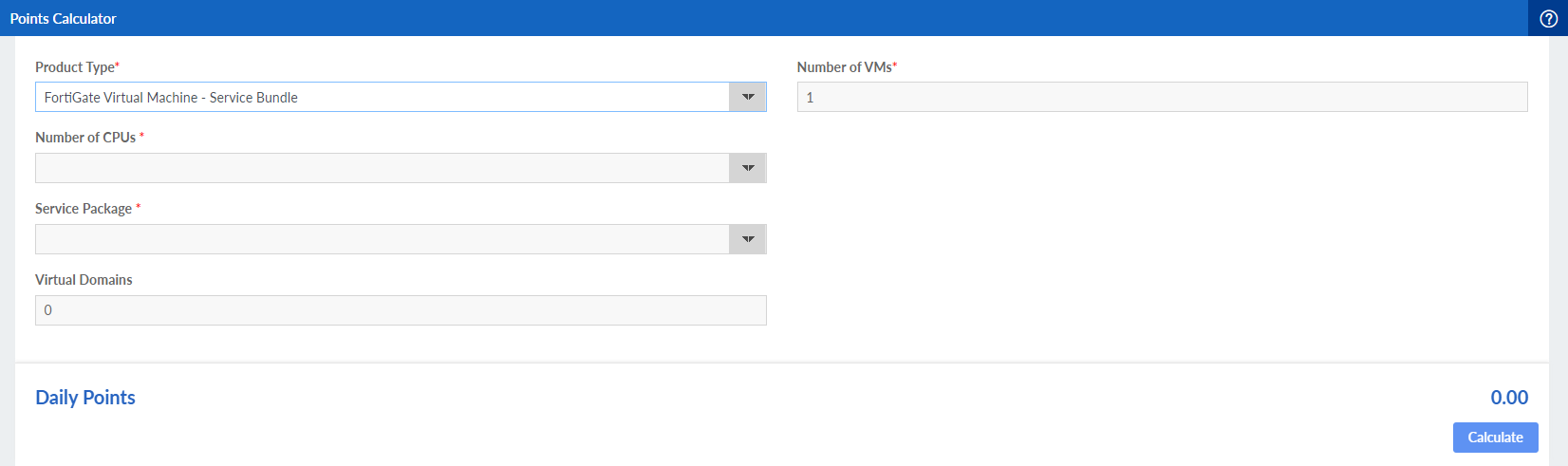

Use the points calculator to calculate how many points will be consumed before you create a new configuration.
The points calculator can be found in the Tools > Points Calculator page, on the Fortinet Developer Network (https://fndn.fortinet.net/index.php?/tools/fortiflex/) or accessed through an API endpoint. Accessing the calculator through an API endpoint provides the current price, latest price, and effective date for the latest price.
To calculate points for a configuration:
  1. Go to Tools > Points Calculator.
  2. From the list select on of the following options.
    • FortiGate Virtual Machine - Service Bundle
    • FortiGate Virtual Machine - A La Carte Services

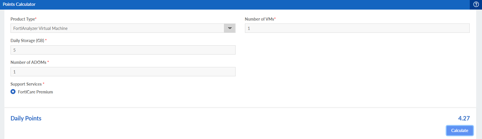

  3. Configure the instance based on the service you selected. The configuration settings will vary depending on the service. For more information, see Service offerings
  4. From the number of Number of VMs dropdown, select the number of VMs.
  5. Click Calculate. The number of points is displayed.
    The Daily Points may display both current and latest pricing. See Daily points for more information.
