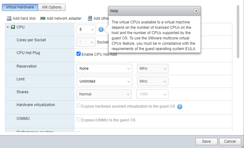

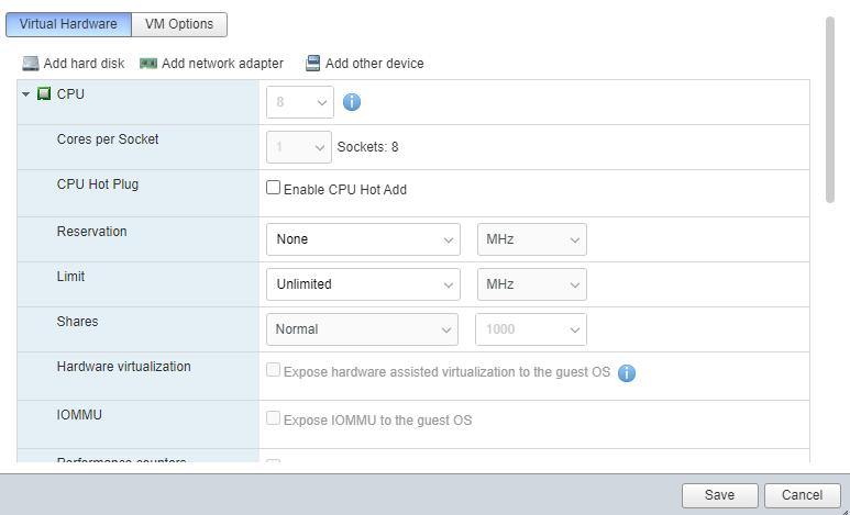

ESXi platform:
Enabling the CPU Hot Add feature in ESXi can lead to this issue. As a workaround, disabling the CPU Hot Add feature may resolve the problem.
Alternatively, if the CPU Hot Add feature is enabled, ensure that the number of vCPUs assigned to the FortiAnalyzer VM is equal to the maximum number of licensed CPUs on the host.

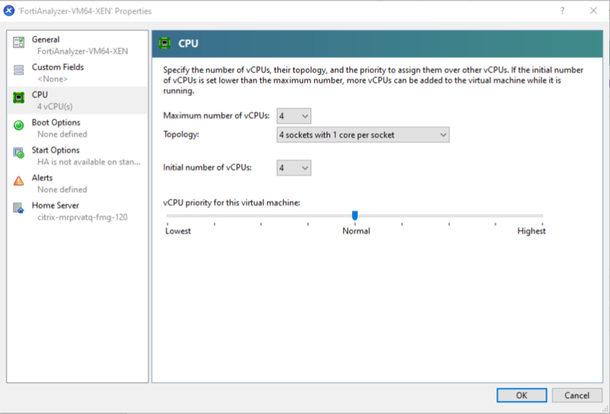

Xen platform:
Ensure that the maximum number of vCPUs is equal to the initial number of vCPUs allocated.

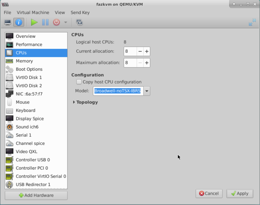

KVM platform:
Verify that the current CPU allocation matches the maximum CPU allocation for the VM.

ESXi platform:
Xen platform:
KVM platform:
