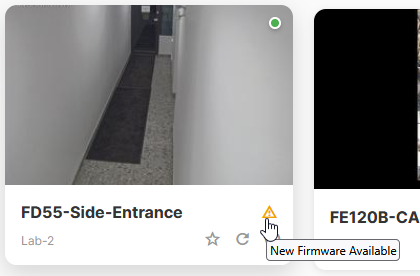

Feature
New firmware availability status
When new firmware is available for cameras, you may want its new features, enhancements, or bug fixes. Owners, Org Admin roles, and Site Admin roles can use the Status column on the Manage Camera dialog. Other users can also now see it when they go to Camera: an attention icon appears on the camera thumbnail image tile; on mouseover, the reason is shown.
New Firmware Available tooltip on camera thumbnail images
