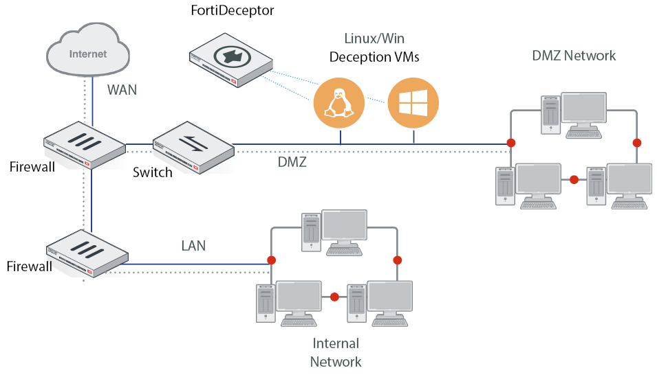

Deploy a FortiDeceptor hardware unit or VM in the Demilitarized Zone (DMZ). You can monitor attacks on the DMZ network when FortiDeceptor is installed in the DMZ network.
DMZ mode is useful when you want to deploy decoys to a segment of the network that hosts critical services. When a threat actor attacks a server and attempts to move laterally inside the DMZ segment they are detected by the decoys without exposing the decoys on the Internet.
