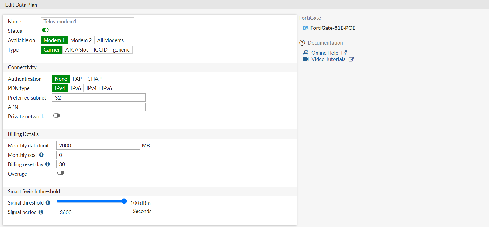

To configure a data plan in the GUI:

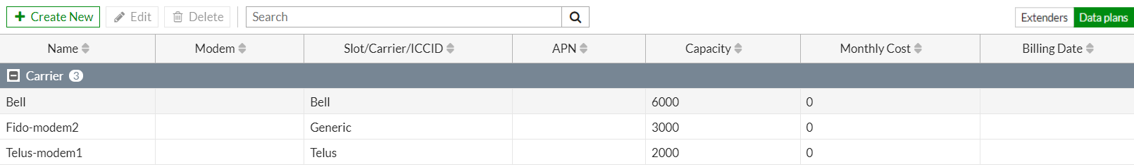

Go to Network > FortiExtender and in the top menu, click Data plans.
Click Create New.
Enter a name and ensure that the Status is enabled.
Set Available on to All Modems or Modem 1.
Set the plan Type. If Carrier is selected, enter the carrier name. If ICCID is selected, enter the ICCID number.
Configure the other settings as needed.
Click OK.

config extender-controller dataplan
edit "Telus-modem1"
set modem-id modem1
set type carrier
set carrier "Telus"
set capacity 2000
set billing-date 30
edit "Fido-modem2"
set modem-id modem2
set type carrier
set carrier "Generic"
set capacity 3000
edit "Bell"
set type carrier
set carrier "Bell"
set APN "pda.bell.ca"
set capacity 6000
