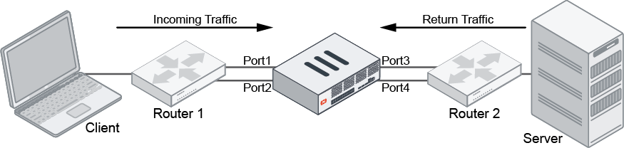

When multiple incoming or outgoing interfaces are used in SD-WAN or for load balancing, changes to routing or incoming or return traffic interfaces impacts how an existing sessions handles the traffic. Auxiliary sessions can be used to handle these changes to traffic patterns.

Scenarios
Incoming traffic is from the client to the server. Return traffic is from the server to the client.
Scenario 1 - Return traffic returns on the original outgoing interface
In this scenario, a session is established between port1 and port3. When the return traffic hits port3:
Auxiliary sessions disabled:
The reply to the client egresses on the original incoming interface, port1. If policy routes or SD-WAN rules are configured, they are not checked.
Auxiliary sessions enabled:
The reply to the client egresses on the best route in the routing table:
  • If the best route is port1, then it will egress on port1.
  • If the best route is port2, then it will egress on port2.
Scenario 2 - Return traffic returns on an interfaces other than the original outgoing interfaces
In this scenario, a session is established between port1 and port3. When the return traffic hits port4:
