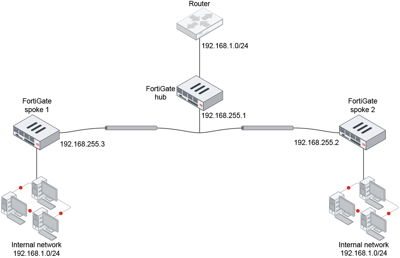

This example describes how to implement VXLAN over IPsec VPN using a VXLAN tunnel endpoint (VTEP).
This example shows a specific configuration that uses a hub-and-spoke topology. However, the same logic can be applied to a static VPN with or without XAuth. In this hub-and-spoke topology, dialup VPN is convenient because it uses a single phase 1 dialup definition on the hub FortiGate. Additional spoke tunnels are added without any changes to the hub, other than adding a user account for each additional spoke. Spoke-to-spoke communication is established through the hub. This example assumes the authentication users and user groups have already been created.
IPsec tunnel interfaces are used to support VXLAN tunnel termination. An IP address is set for each tunnel interface. Ping access is allowed for troubleshooting purposes.
VTEPs are created on each of the hub and spokes in order to forward VXLAN traffic through the IPsec tunnels. VXLAN encapsulates OSI layer 2 Ethernet frames within layer 3 IP packets. You will need to either combine the internal port and VXLAN interface into a soft switch, or create a virtual wire pair so that devices behind port1 have direct layer 2 access to remote peers over the VXLAN tunnel. This example uses a switch interface on the hub and a virtual wire pair on the spokes to demonstrate the two different methods.
Finally, in order to apply an IPsec VPN interface on the VXLAN interface setting, net-device must be disabled in the IPsec VPN phase 1 settings. All VXLAN interfaces in this example share the same VXLAN network ID (vni).
To configure the hub FortiGate:
- Configure the phase 1 and phase 2 interfaces:
config vpn ipsec phase1-interface edit "SPOKES" set type dynamic set interface "port2" set mode aggressive set peertype one set net-device disable set proposal aes256-sha256 set xauthtype auto set authusrgrp "SPOKES" set peerid "SPOKES" set psksecret <secret> next end config vpn ipsec phase2-interface edit "SPOKES" set phase1name "SPOKES" set proposal aes128-sha1 aes256-sha1 aes128-sha256 aes256-sha256 aes128gcm aes256gcm chacha20poly1305 next end - Configure the IPsec VPN policy that allows VXLAN traffic between spokes:
config firewall policy edit 1 set name "VXLAN_SPOKE_to_SPOKE" set srcintf "SPOKES" set dstintf "SPOKES" set srcaddr "NET_192.168.255.0" set dstaddr "NET_192.168.255.0" set action accept set schedule "always" set service "UDP_4789" set logtraffic all set fsso disable next end - Configure the IPsec tunnel interfaces (the remote IP address is not used, but it is necessary for this configuration):
config system interface edit "SPOKES" set vdom "root" set ip 192.168.255.1 255.255.255.255 set allowaccess ping set type tunnel set remote-ip 192.168.255.254 255.255.255.0 set snmp-index 12 set interface "port2" next end - Configure the VXLAN interface (the remote IP is the tunnel interfaces IPs of the spokes):
config system VXLAN edit "SPOKES_VXLAN" set interface "SPOKES" set vni 1 set remote-ip "192.168.255.2" "192.168.255.3" next end
To configure the spoke FortiGates:
config vpn ipsec phase1-interface edit "HUB" set interface "port2" set mode aggressive set peertype any set net-device disable set proposal aes256-sha256 set localid "SPOKES" set xauthtype client set authusr "SPOKE1" set authpasswd <secret> set remote-gw <hub public IP> set psksecret <secret> next end config vpn ipsec phase2-interface edit "HUB" set phase1name "HUB" set proposal aes128-sha1 aes256-sha1 aes128-sha256 aes256-sha256 aes128gcm aes256gcm chacha20poly1305 set auto-negotiate enable set src-subnet 192.168.255.2 255.255.255.255 next end
The hub FortiGate inserts a reverse route pointing to newly established tunnel interfaces for any of the subnets that the spoke FortiGate's source quick mode selectors provides. This is why you should set the tunnel IP address here.
- Configure the IPsec VPN policy:
config firewall policy edit 1 set name "VTEP_IPSEC_POLICY" set srcintf "HUB" set dstintf "HUB" set srcaddr "none" set dstaddr "none" set action accept set schedule "always" set service "PING" set logtraffic disable set fsso disable next end - Configure the IPsec tunnel interfaces:
config system interface edit "HUB" set vdom "root" set ip 192.168.255.2 255.255.255.255 set allowaccess ping set type tunnel set remote-ip 192.168.255.1 255.255.255.0 set snmp-index 12 set interface "port2" next end - Configure the VXLAN interface (the remote IP is the tunnel interface IP of the hub):
config system VXLAN edit "HUB_VXLAN" set interface "HUB" set vni 1 set remote-ip "192.168.255.1" next endTo establish a VXLAN tunnel between spokes, you can add a spoke's tunnel IP address in
remote-ip.
To add more remote IP addresses to a VXLAN interface, the interface cannot be in use. You may want to provision future spokes' remote IP addresses at this point to avoid traffic disruption. Otherwise, you must delete the reference (the policy in this example) before adding remote IP addresses.
