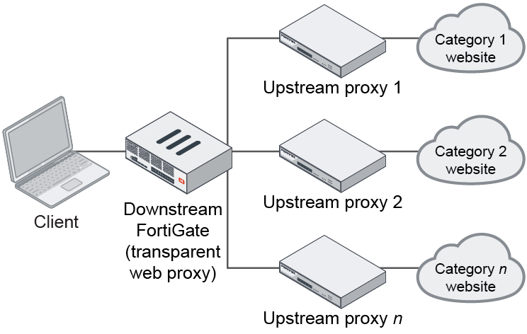

Selectively forward web requests to a transparent web proxy
Web traffic over HTTP/HTTPS can be forwarded selectively by the FortiGate's transparent web proxy to an upstream web proxy to avoid overwhelming the proxy server. Traffic can be selected by specifying the proxy address (set webproxy-forward-server), which can be based on a FortiGuard URL category.
The FortiGuard web filter service must be enabled on the downstream FortiGate. |
Topology
Forwarding behavior

On the downstream FortiGate proxy, there are two category proxy addresses used in two separate transparent web proxy policies as the destination address:
In the policy with
upstream_proxy_1as the forward server, the proxy addresscategory_infotechis used to match URLs in the information technology category. -
In the policy with
upstream_proxy_2as the forward server, the proxy addresscategory_socialis used to match URLs in the social media category.
