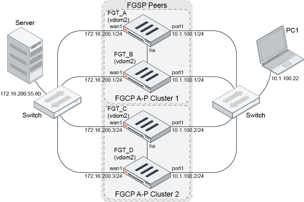

Example
In this example, there is a simplified configuration where there is no router or load balancer performing balancing between the FGSP peers, but it demonstrates the following:
- When sessions pass through FGCP A-P Cluster 1, all sessions are synchronized between the FGT_A and FGT_B regardless of the session synchronization filter.
- Session synchronization between the FGSP peers (FGCP A-P Cluster 1 and 2) only occurs for the service specified in the filter, which is HTTP/80.

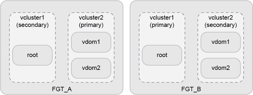

- The preceding behavior is applicable when virtual clustering is configured. This example focuses on vdom2, which belongs to vcluster2. FGT_A is the primary for vcluster2.
Each FGSP A-P cluster is connected on ha as the FGCP cluster heartbeat device. The FGSP peers are connected on mgmt over 10.1.1.1-2/24.
Virtual clustering between FGT_A and FGT_B:

To configure the HA clusters:
Configure FGCP A-P Cluster 1 (use the same configuration for FGT_A and FGT_B):
config system ha set group-id 146 set group-name "FGT_HA1" set mode a-p set hbdev "wan2" 100 "ha" 50 set session-pickup enable set vcluster-status enable config vcluster edit 1 set override enable set priority 25 set monitor "wan1" "port1" set vdom "root" next edit 2 set override disable set priority 150 set monitor "wan1" set vdom "vdom2" "vdom1" next end end -
Configure FGCP A-P Cluster 2 (use the same configuration for FGT_C and FGT_D):
config system ha set group-id 200 set group-name "FGT_HA2" set mode a-p set hbdev "wan2" 100 "ha" 50 set session-pickup enable set vcluster-status enable config vcluster edit 1 set override enable set priority 120 set monitor "wan1" "port1" set vdom "root" next edit 2 set override disable set priority 150 set monitor "wan1" set vdom "vdom2" "vdom1" next end end
