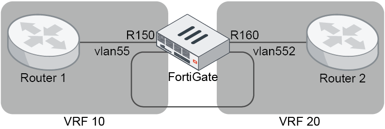

Using a VRF leak on BGP
In this example, the route 2000:5:5:5::/64 learned from Router 1 is leaked to VRF 20 through the interface vlan552. Conversely, the route 2009:3:3:3::/64 learned from Router 2 is leaked to VRF 10 through interface vlan55.
