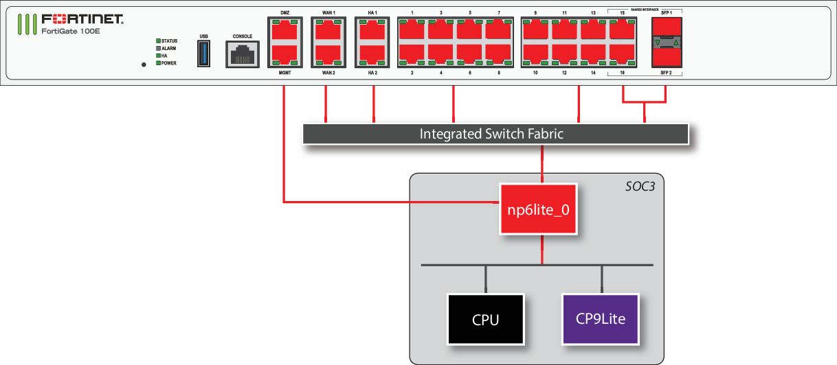

FortiGate 100E and 101E fast path architecture
The FortiGate 100E and 101E includes the SOC3 and uses the SOC3 CPU, NP6Lite processor, and CP9Lite processor. The WAN1, WAN2, HA1, HA2, 1 - 16, SFP1, and SFP2 interfaces connect to the NP6Lite processor through the integrated switch fabric. The DMZ and MGMT interfaces connect directly to the NP6Lite processor.
Interfaces 15 and SFP1 are paired and interfaces 16 and SFP2 are paired. Only one of each interface pair can be connected to a network at a time. This allows you to, for example, connect interface SFP1 to an SFP switch and interface 16 to a 10/100/1000BASE-T Copper switch.

You can use the following get command to display the FortiGate 100E or 101E NP6Lite configuration. You can also use the diagnose npu np6lite port-list command to display this information.
get hardware npu np6lite port-list
