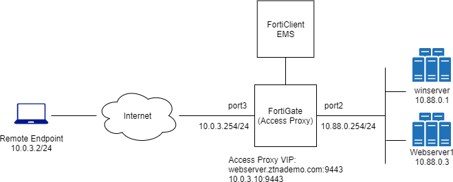

In this example, the FortiGate is configured with a ZTNA HTTPS access proxy to protect access to the web server. It uses session-based form authentication with cookies and auth-portal enabled. It connects to the internal Windows Active Directory using LDAPS for user authentication, and assigns FortiToken MFA to individual users.
This example assumes that the FortiGate EMS Fabric connector is already successfully connected.

Configure the network settings:
Set External interface to port3.
Set External IP to 10.0.3.10.
Set External port to 9443.
Select the Default certificate. Clients will be presented with this certificate when they connect to the access proxy VIP. In this example, the custom certificate, ztna-wildcard is selected.

Add a server:
In the Servers table, click Create New.
Set IP to 10.88.0.3.
Set Port to 9443.
Click OK to complete the server settings.

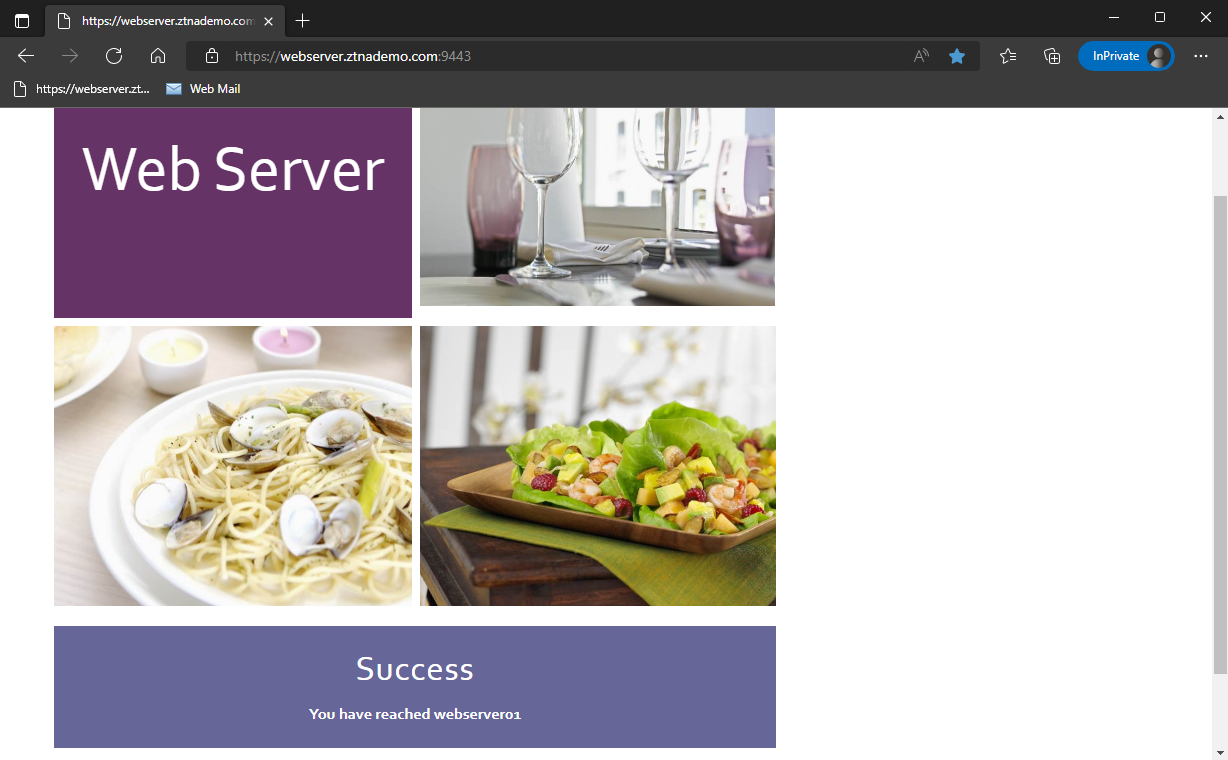

- Open a browser and enter the address or FQDN of the server and the access port. In this example, https://webserver.ztnademo.com:9443 resolves to https://10.0.3.10:9443.
- The browser prompts for the client certificate to use. Select the EMS signed certificate, then click OK.
- The client is verified by the FortiGate to authenticate your identity.

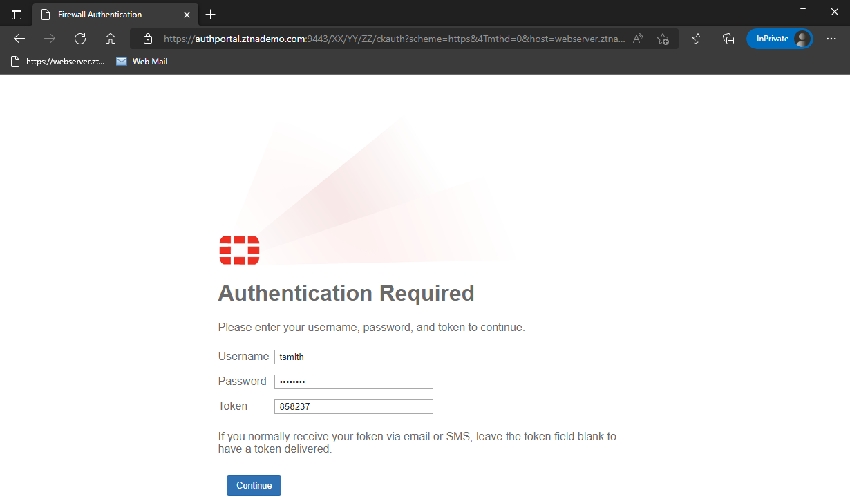

- Form authentication redirects you to the captive portal defined by the
auth-virtual-host, authportal.ztnademo.com:9443. Enter your user credentials and FortiToken code.
- After the user authentication passes, the FortiGate performs a posture check on the endpoint. When the posture check passes, you are allowed access to the website.
