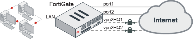

Example 3: Weight-based ECMP
config router static
edit 3
set dst 10.10.30.0 255.255.255.0
set weight 80
set device "vpn2HQ1"
edit 5
set weight 20
set device "vpn2HQ2"
# get router info routing-table all
Routing table for VRF=0
S 10.10.30.0/24 [10/0] is directly connected, vpn2HQ1, [0/80]
[10/0] is directly connected, vpn2HQ2, [0/20]
C 172.16.151.0/24 is directly connected, port1
C 192.168.0.0/24 is directly connected, port3
C 192.168.2.0/24 is directly connected, port2
Result:
Both routes are added to the routing table, but 80% of the sessions to 10.10.30.0/24 are routed to vpn2HQ1, and 20% are routed to vpn2HQ2.
