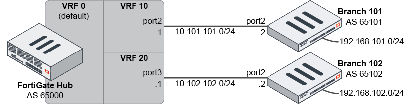

BGP
In this example, BGP is used to update the VRF that it is neighbors with.
The hub is configured with two neighbors connected to two interfaces. The branches are configured to match the hub, with branch networks configured to redistribute into BGP.
Policies must be created on the hub and branches to allow traffic between them.

To configure VRF on the hub:
Put the interfaces into VRF:
config system interface edit port2 set vrf 10 next edit port3 set vrf 20 next end -
