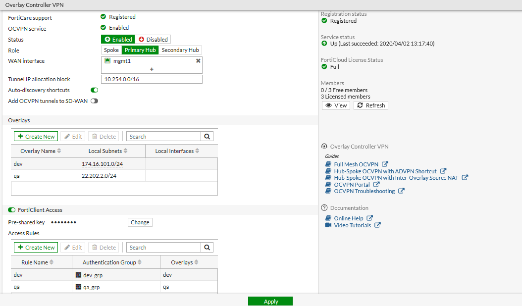

To configure remote FortiClient access to an OCVPN hub in the GUI:
  1. On the primary hub, configure the users and user groups required for the FortiClient dialup user authentication and authorization. In this example, there are two user groups (dev_grp and qa_grp).
  2. Go to VPN > Overlay Controller VPN and in the Overlays section, click Create New.
  3. Enter a name and the local subnet (174.16.101.0/24 for dev and 22.202.2.0/24 for qa).
  4. Enable FortiClient Access.
  5. In the Access Rules section, click Create New.
  6. Enter a name, and select the authentication groups and overlays.The authentication groups will be used by the IPsec phase 1 interface for authentication, and by firewall policies for authorization. The overlay allows access to the resource.
  7. Click OK.
  8. Create more rules if needed.
  9. Click Apply.

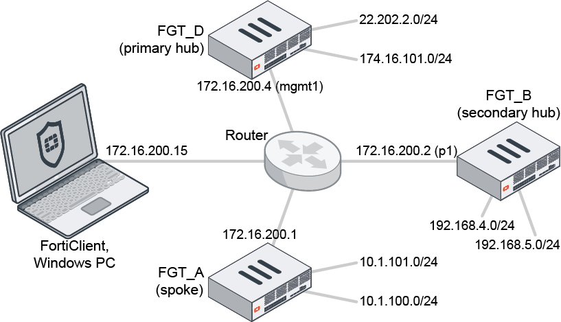

To view data on the PC running FortiClient:
C:\ route print
IPv4 Route Table
Active Routes:
Network Destination        Netmask          Gateway       Interface  Metric
          0.0.0.0          0.0.0.0       10.1.100.5      10.1.100.13    281
       10.1.100.0    255.255.255.0     10.254.128.2     10.254.128.1      1
      10.1.100.13  255.255.255.255         On-link       10.1.100.13    281
       10.1.101.0    255.255.255.0     10.254.128.2     10.254.128.1      1
        10.6.30.0    255.255.255.0         On-link        10.6.30.13    281
       10.6.30.13  255.255.255.255         On-link        10.6.30.13    281
      10.6.30.255  255.255.255.255         On-link        10.6.30.13    281
       10.254.0.0      255.255.0.0     10.254.128.2     10.254.128.1      1
     10.254.128.1  255.255.255.255         On-link      10.254.128.1    257
       22.202.2.0    255.255.255.0     10.254.128.2     10.254.128.1      1
        127.0.0.0        255.0.0.0         On-link         127.0.0.1    331
        127.0.0.1  255.255.255.255         On-link         127.0.0.1    331
  127.255.255.255  255.255.255.255         On-link         127.0.0.1    331
     172.16.200.4  255.255.255.255       10.1.100.5      10.1.100.13     25
     174.16.101.0    255.255.255.0     10.254.128.2     10.254.128.1      1
        224.0.0.0        240.0.0.0         On-link         127.0.0.1    331
        224.0.0.0        240.0.0.0         On-link      10.254.128.1    257
        224.0.0.0        240.0.0.0         On-link        10.6.30.13    281
        224.0.0.0        240.0.0.0         On-link       10.1.100.13    281
  255.255.255.255  255.255.255.255         On-link         127.0.0.1    331
  255.255.255.255  255.255.255.255         On-link      10.254.128.1    257
  255.255.255.255  255.255.255.255         On-link        10.6.30.13    281
  255.255.255.255  255.255.255.255         On-link       10.1.100.13    281
Persistent Routes:
  Network Address          Netmask  Gateway Address  Metric
          0.0.0.0          0.0.0.0       10.1.100.5  Default
The PC can access the dev resource overlay, but not qa:
C:\Users\tester>ping 174.16.101.44
Pinging 174.16.101.44 with 32 bytes of data:
Reply from 174.16.101.44: bytes=32 time=1ms TTL=63
Ping statistics for 174.16.101.44:
    Packets: Sent = 4, Received = 4, Lost = 0 (0% loss),
Approximate round trip times in milli-seconds:
    Minimum = 1ms, Maximum = 1ms, Average = 1ms
C:\Users\tester>ping 22.202.2.2
Pinging 22.202.2.2 with 32 bytes of data:
Request timed out.
Request timed out.
Request timed out.
Request timed out.
Ping statistics for 22.202.2.2:
    Packets: Sent = 4, Received = 0, Lost = 4 (100% loss),
