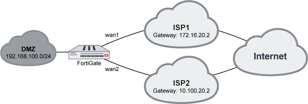

In this example, your wan1 and wan2 SD-WAN interfaces connect to two ISPs that both go to the public internet. The cost of wan2 is less than that of wan1. You want to configure Gmail services to use the lowest cost interface, but the link quality must meet a standard of latency: 10ms, and jitter: 5ms.

  1. On the FortiGate, add wan1 and wan2 as SD-WAN members, then add a policy and static route. See SD-WAN quick start for details.

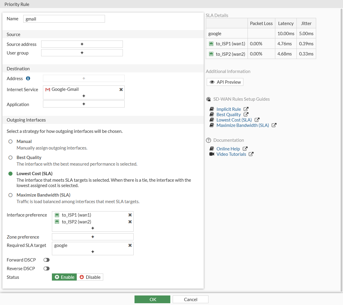

  3. Go to Network > SD-WAN, select the SD-WAN Rules tab, and click Create New.
  4. Enter a name for the rule, such as gmail.
  5. Configure the following settings:
    Internet Service
    Google-Gmail
    Strategy
    Lowest Cost (SLA)
    Interface preference
    wan1 and wan2
    Required SLA target
    google (created in step 2).
  6. Click OK to create the rule.
  2. Create a new Performance SLA named google that includes an SLA Target with Latency threshold = 10ms and Jitter threshold = 5ms. See Link monitoring example.
    Internet Service
    Google-Gmail
    Strategy
    Lowest Cost (SLA)
    wan1 and wan2
    Required SLA target
