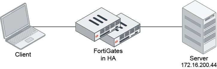

In this example, OpenSSL is used to create a TLS session between the client and the server through the primary FortiGate. The session ticket is outputted and saved. Upon failover, the same session ticket is reused to create a TLS session through the new primary unit. Because the new primary unit uses the same certificate to generate the key for the TLS session ticket, it allows the connection to be made using an abbreviated TLS handshake.

  1. On the client using OpenSSL, open a new session to 172.16.200.44:443 and output the session ticket to a file called aaa.txt. This session will pass through the current HA primary unit:
    # openssl s_client -connect 172.16.200.44:443 -sess_out aaa.txt
  2. Fail over the primary unit to the secondary unit. The HA secondary unit starts handling the traffic.
  3. On the client, try connecting to 172.16.200.44:443 using the same saved session ticket as before (aaa.txt):
    # openssl s_client -connect 172.16.200.44:443 -sess_in aaa.txt
  4. Verify whether the session succeeds in using the original session ticket:
    Reused, TLSv1.3, Cipher is TLS_AES_256_GCM_SHA384
    Server public key is 4096 bit
    Secure Renegotiation IS NOT supported
    Compression: NONE
    Expansion: NONE
    No ALPN negotiated
    Early data was not sent
    Verify return code: 19 (self signed certificate in certificate chain)
    If the session is established using the same ticket, Reused, TLSv1.3, Cipher is <name> is displayed. If session is established using a new ticket, New, TLSv1.3, Cipher is <name> is displayed.
    The new primary is able to use the web proxy global ssl-ca-cert to generate the same key as the old primary that was used in the session ticket. So, the second TLS connection that reuses the TLS session ticket from the first session can complete an abbreviated TLS handshake.
