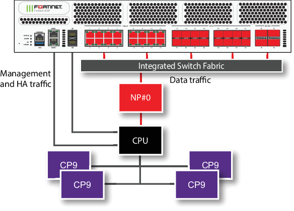

The FortiGate 2600F and 2601F each include one NP7 processor. All front panel data interfaces and the NP7 processor connect to the integrated switch fabric (ISF). All data traffic passes from the data interfaces through the ISF to the NP7 processor. All supported traffic passing between any two data interfaces can be offloaded by the NP7 processor. Data traffic processed by the CPU takes a dedicated data path through the ISF and the NP7 processor to the CPU.
The FortiGate 2600F and 2601F feature the following front panel interfaces:

The MGMT interfaces are not connected to the NP7 processor. Management traffic passes to the CPU over a dedicated management path that is separate from the data path. You can also dedicate separate CPU resources for management traffic to further isolate management processing from data processing (see Improving GUI and CLI responsiveness (dedicated management CPU)).
The HA interfaces are also not connected to the NP7 processor. To help provide better HA stability and resiliency, HA traffic uses a dedicated physical control path that provides HA control traffic separation from data traffic processing.
The separation of management and HA traffic from data traffic keeps management and HA traffic from affecting the stability and performance of data traffic processing.
You can use the following command to display the FortiGate 2600F or 2601F NP7 configuration. The command output shows a single NP7 named NP#0 is connected to all interfaces. This interface to NP7 mapping is also shown in the diagram above.

NP Port:
Name   Switch_id SW_port_id SW_port_name
np0_0  0         45         ce4
np0_1  0         49         ce5
* Max_speed: Maximum speed, Dflt_speed: Default speed
* SW_port_id: Switch port ID, SW_port_name: Switch port name
The command output also shows the maximum and default speeds of each interface.
The NP7 processor has a bandwidth capacity of 200 Gigabits. You can see from the command output that if all interfaces were operating at their maximum bandwidth the NP7 processor would not be able to offload all the traffic.
The FortiGate-2600F and 2601F can be licensed for hyperscale firewall support, see the Hyperscale Firewall Guide.

Each NP7 has two 100-Gigabit KR links, numbered 0 and 1. Traffic passes to the NP7 over these links. By default the two links operate as a LAG that distributes sessions to the NP7 processor. You can configure the NPU port map to assign interfaces to use one or the other of the NP7 links instead of sending sessions over the LAG.
<index> varies depending on the NP7 processors available in your FortiGate.
For the FortiGate-2600F <index> can be 0, 1, or 2:
  • 0, assign the interface to NP#0, the default, the interface is connected to the LAG. Traffic from the interface is distributed to both links.
  • 1, assign the interface to NP#0-link0, to connect the interface to NP7 link 0. Traffic from the interface is set to link 0.
  • 2, assign the interface to NP#0-link1, to connect the interface to NP7 link 1. Traffic from the interface is set to link 1.
