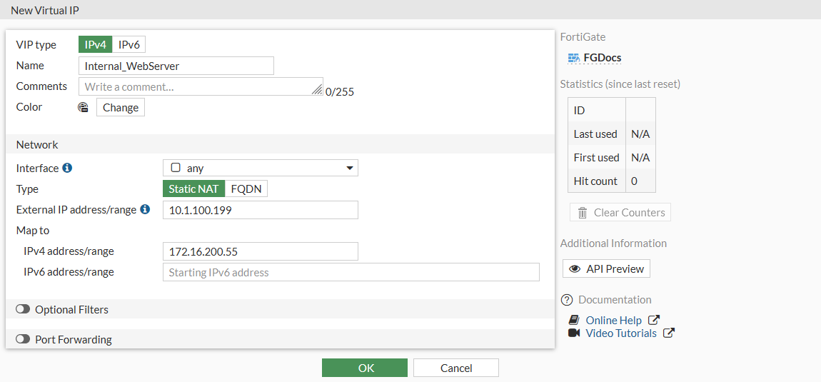

To create a virtual IP in the GUI:
In Policy & Objects > Virtual IPs and click Create New > Virtual IP.
Select a VIP Type based on the IP versions used.
Enter a unique name for the virtual IP.
Enter values for the external IP address/range and map to IPv4/IPv6 address/range fields.
Click OK.

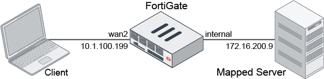

To create a virtual IP in the CLI:
config firewall vip
edit "Internal_WebServer"
set extip 10.1.100.199
set extintf "any"
set mappedip "172.16.200.55"
To apply a virtual IP to policy in the CLI:
config firewall policy
edit 8
set name "Example_Virtual_IP_in_Policy"
set srcintf "wan2"
set dstintf "internal"
set srcaddr "all"
set dstaddr "Internal_WebServer"
set service "ALL"
set nat enable
