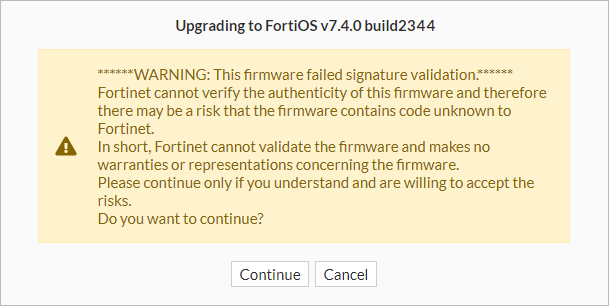

When upgrading from 7.2.4 to 7.4.0 with an unsigned firmware image in the GUI, FortiOS is unable to verify the certificates and the image fails verification. The upgrade will still occur. However, during the upgrade process, a warning dialog is displayed indicating that This firmware failed signature validation. The user can click Continue to upgrade the firmware.

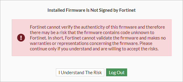

When the user logs in to the FortiGate running 7.4.0, a warning dialog is displayed indicating that the Installed Firmware is Not Signed by Fortinet. The user can click I Understand The Risk to log in.

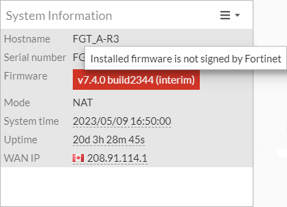

Top banner: the unsigned firmware version is highlighted in red. Hovering over the unsigned firmware version displays a tooltip that the Installed firmware is not signed by Fortinet.
Dashboard > Status > System Information widget: the unsigned firmware version is highlighted in red. Hovering over the unsigned firmware version displays a tooltip that the Installed firmware is not signed by Fortinet.
