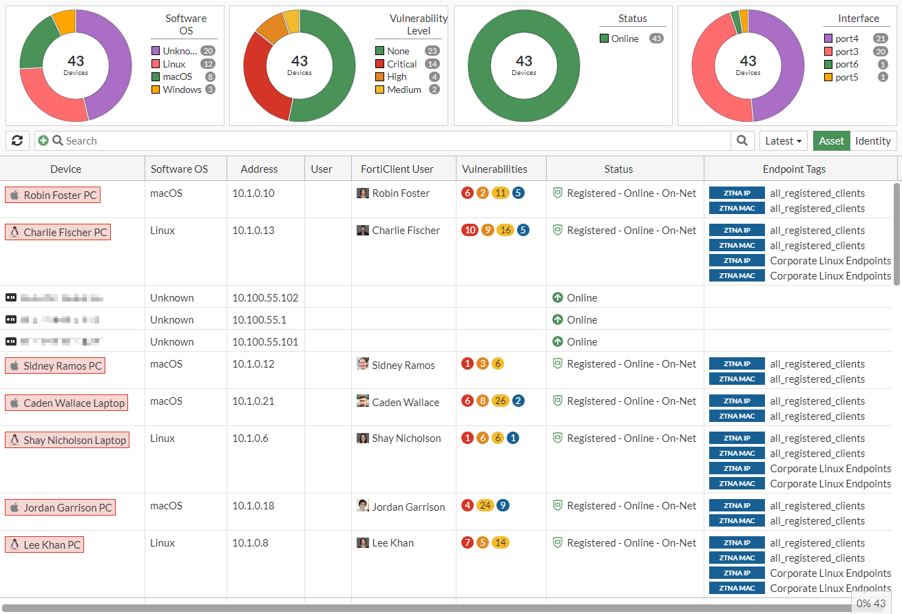

The Asset Identity Center page unifies information from detected addresses, devices, and users into a single page, while building a data structure to store the user and device information in the backend. The Asset view groups information by Device, while the Identity view groups information by User. Hover over a device or a user in the GUI to perform different actions relevant to the object, such as adding a firewall device address, adding an IP address, banning the IP, quarantining the host, and more.
To view the Asset Identity Center page:
Go to Security Fabric > Asset Identity Center.

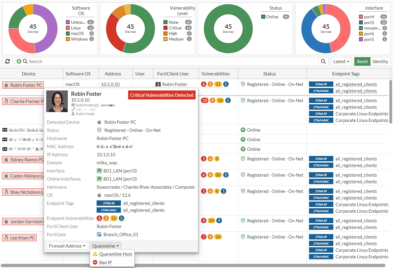

Click Asset to view information by device.
There are four donut charts with device related information: Software OS, Vulnerability Level, Status, and Interface.
The default table columns are Device, Software OS, Address, User, FortiClient User, Vulnerabilities, Status, and Endpoint Tags. The optional columns are Device Family, Device Type, EMS Serial, EMS Tenant ID, Firewall Address, FortiSwitch, Hardware Vendor, Hardware Version, Hostname, Interface, IP Address, Last Seen, Port, Server, VLAN, and Vulnerability Level.
Devices with vulnerabilities are highlighted in red.

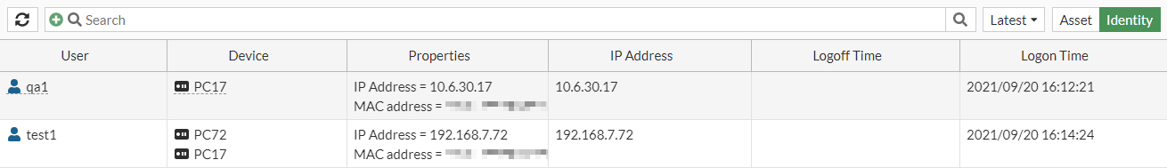

Click Identity to view information by user. The default table columns are User, Device, and Properties. The optional columns are IP Address, Logoff Time, and Logon Time.
Each view has a dropdown option to view the information within different time frames (Latest, 1 hour, 24 hours, and 7 days). The page displays user and device relationships, such as which users are logged in to multiple devices or if multiple users are logged in to single devices.
Hover over a device in the list to view the tooltip and possible actions. The options under the Firewall Address dropdown are Create Firewall Device Address and Create Firewall IP Address. The options under the Quarantine dropdown are Quarantine Host and Ban IP.

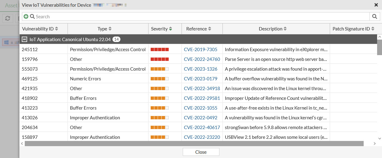

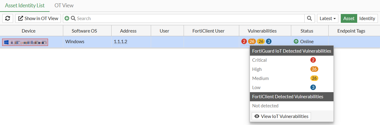

Hovering over the data in the Vulnerabilities column displays a list of FortiGuard IoT Detected Vulnerabilities and FortiClient Detected Vulnerabilities. Clicking the View IoT Vulnerabilities button in the tooltip opens the View IoT Vulnerabilities table that includes the Vulnerability ID, Type, Severity, Reference, Description, and Patch Signature ID. Each entry in the Reference column includes the CVE number and a link to the CVE details.
The following settings are required to display IoT devices:
The FortiGate must have a valid IoT Detection Service license.
Device detection must be configured on a LAN interface used by IoT devices.
To configure device detection in the GUI:
- Go to Network > Interfaces and edit a LAN interface.
- Enable Device detection.
- Click OK.
To configure device detection in the CLI:
config system interface edit <name> set device-identification enable next end -
Configure a firewall policy with an application control sensor.
To view IoT asset vulnerabilities in the GUI:
Go to Security Fabric > Asset Identity Center. Ensure the Asset list view is selected.
Select a device with IoT vulnerabilities.
Hover over the IoT Vulnerabilities count to view the tooltip and click View IoT Vulnerabilities.
A table with the list of vulnerabilities and related information for the device is displayed, including the CVE references and descriptions.
Click a hyperlink in the Reference column to view more information about the CVE, or click Close.

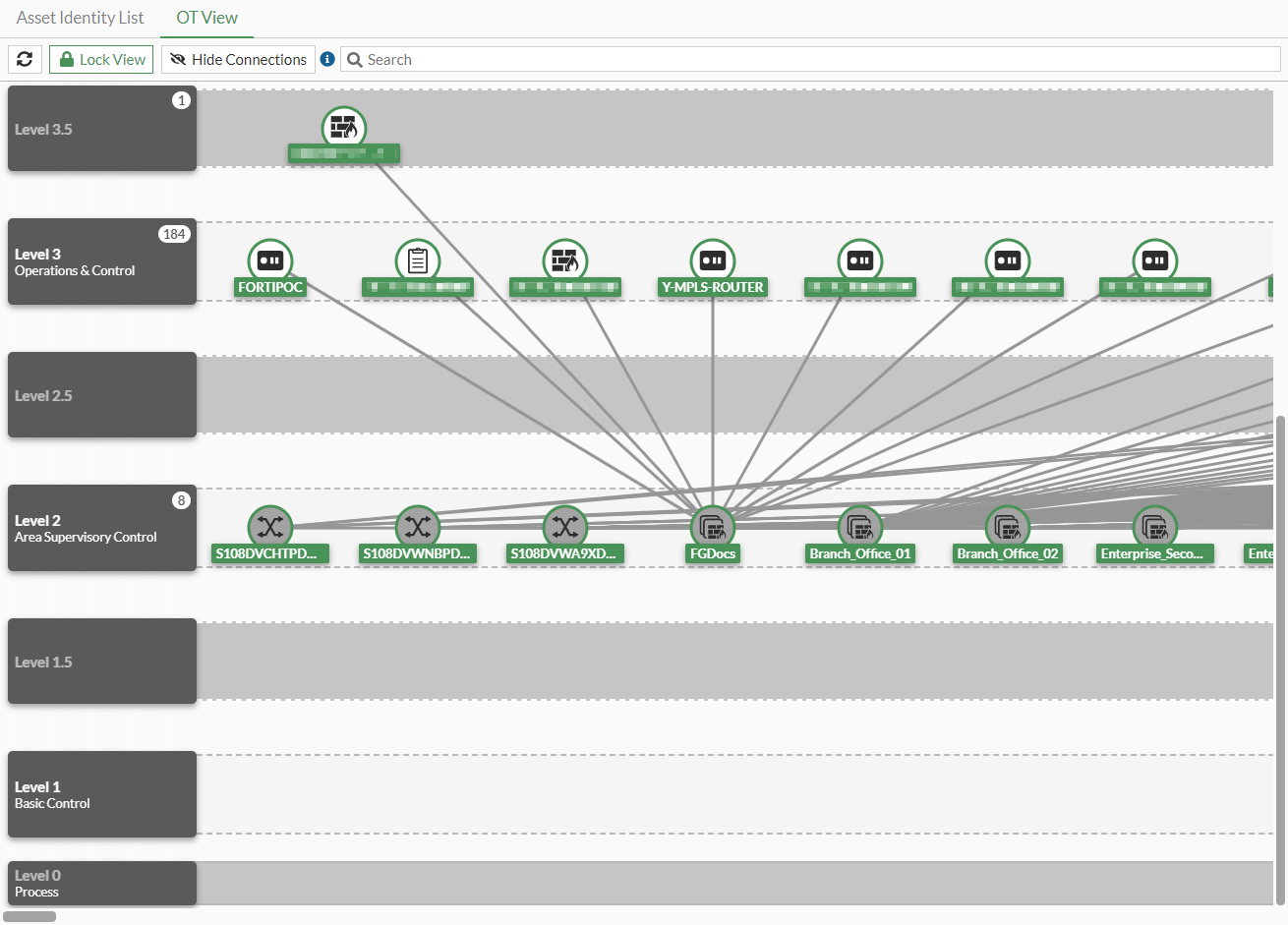

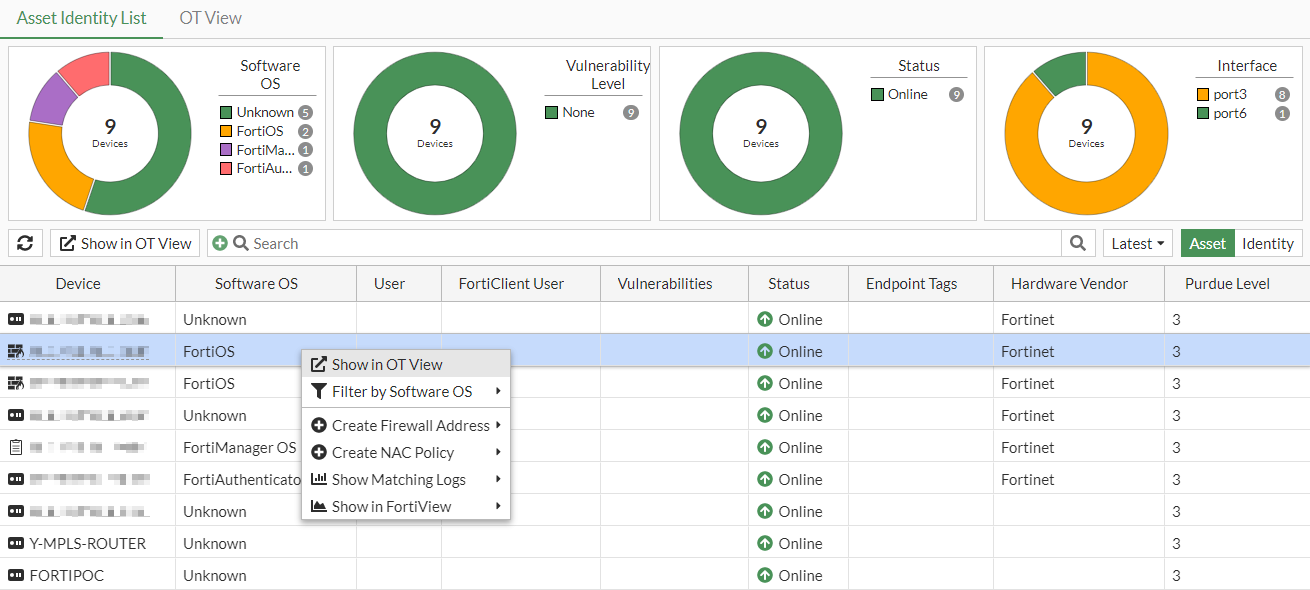

Once enabled, the Security Fabric > Asset Identity Center page displays an Asset Identity List tab and an OT View tab.
- The Asset Identity List tab includes a configurable Purdue Level column and a Show in OT View option for selected devices in the table.

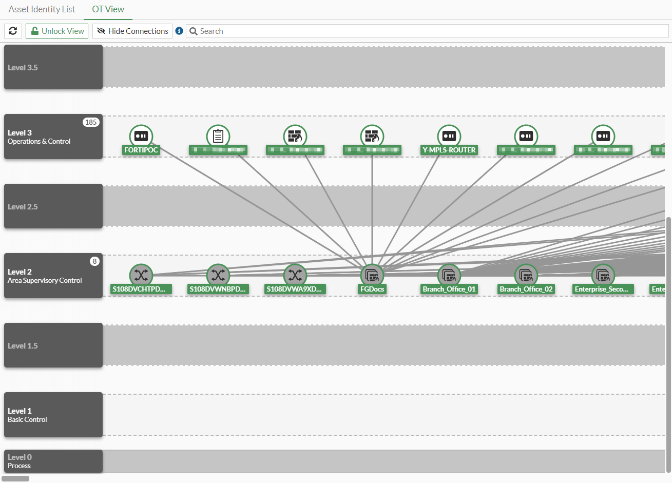

- The OT View tab shows a topology of detected components and connections mapped to Purdue Levels. The default view is locked, but devices can be dragged and dropped to other Purdue Levels if the view is unlocked.
FortiGates and managed FortiSwitches are statically assigned Purdue Level 2 and cannot be changed. Other detected devices are assigned Purdue Level 3 by default and can be changed (except to level S, 0, or external).

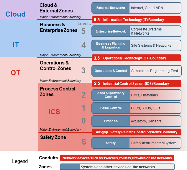

The following diagram lists the Purdue Levels based on OT network topologies:

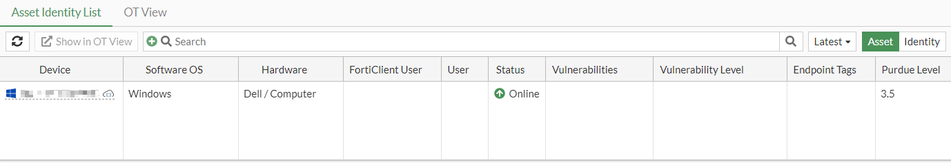

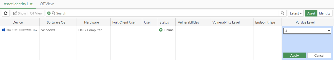

To change the Purdue Level in the Asset Identity List tab:
- Go to Security Fabric > Asset Identity Center and select the Asset Identity List tab.
- Add the Purdue Level column to the table:
- Hover over the table header and click the gear icon (Configure Table).
- Select Purdue Level.
- Click Apply.
- Select a device and hover over the Purdue Level value.
- Click the pencil icon to edit the level.
- Select a value from the dropdown.
- Click Apply.
To change the Purdue Level in the OT View tab:
- Go to Security Fabric > Asset Identity Center and select the OT View tab.
- Click Unlock View.
- Select a device.
- Drag the device icon to another level row.
- Optionally, click Lock View to revert to the locked view.

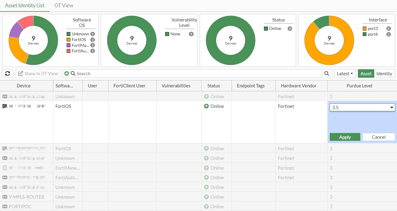

To configure the default Purdue Level:
Configure the interface settings:
config system interface edit "port1" set device-identification enable set default-purdue-level 3.5 next end -
Verify that the Purdue Level as been updated in the user device store list:
# diagnose user-device-store device memory list Record #1: device_info 'ipv4_address' = '192.168.1.64' 'mac' = '**:**:**:**:**:**' 'hardware_vendor' = 'Dell' 'hardware_type' = 'Home & Office' 'hardware_family' = 'Computer' 'vdom' = 'root' 'os_name' = 'Windows' 'os_version' = '10 / 2016' 'last_seen' = '1680115135' 'host_src' = 'mwbs' 'unjoined_forticlient_endpoint' = 'false' 'is_online' = 'true' 'active_start_time' = '1680113976' 'dhcp_lease_status' = 'leased' 'dhcp_lease_expire' = '1680651757' 'dhcp_lease_reserved' = 'false' 'dhcp_server_id' = '2' 'is_fortiguard_src' = 'true' 'purdue_level' = '3.5' ... -
Go to Security Fabric > Asset Identity Center and select the Asset Identity List tab. The device's Purdue Level is currently 3.5.
Manually change the device's Purdue Level:
Select the device and hover over the Purdue Level value.
Select 4 and click Apply.
