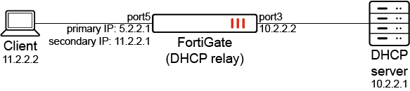

DHCP relays can be configured on interfaces with secondary IP addresses. The FortiGate will track the number of unanswered DHCP requests for a client on the interface's primary IP. After three unanswered DHCP requests, the FortiGate will forward DHCP requests to DHCP relays configured under the secondary IP using the secondary IP address as the source. After three unanswered DHCP requests, the FortiGate will return to using the primary IP and restart the process.

In this example, DHCP smart relay is configured on port5 with a DHCP relay IP address of 10.2.2.1.
To configure DHCP smart relay on interfaces with a secondary IP:

  2. Verify the debug messages to check that the DHCP relay is working. After three unanswered DHCP requests, the request is forwarded to the secondary IP DHCP relay target:
