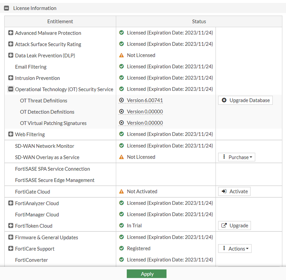

To view the entitlement information in the GUI:
Go to System > FortiGuard.
Expand the Operational Technology (OT) Security Service entry in the License Information table.
To view the entitlement information in the CLI:
# diagnose autoupdate versions | grep OT -A7 OT Threat Definitions --------- Version: 6.00741 signed Contract Expiry Date: Sat Sep 16 2023 Last Updated using manual update on Tue Dec 1 02:30:00 2015 Last Update Attempt: n/a Result: Updates Installed -- OT Detect Definitions --------- Version: 0.00000 Contract Expiry Date: Sat Sep 16 2023 Last Updated using manual update on Mon Jan 1 00:00:00 2001 Last Update Attempt: Mon Aug 14 15:42:43 2023 Result: No Updates OT Patch Definitions --------- Version: 0.00000 Contract Expiry Date: Sat Sep 16 2023 Last Updated using manual update on Mon Jan 1 00:00:00 2001 Last Update Attempt: Mon Aug 14 15:42:43 2023 Result: No Updates

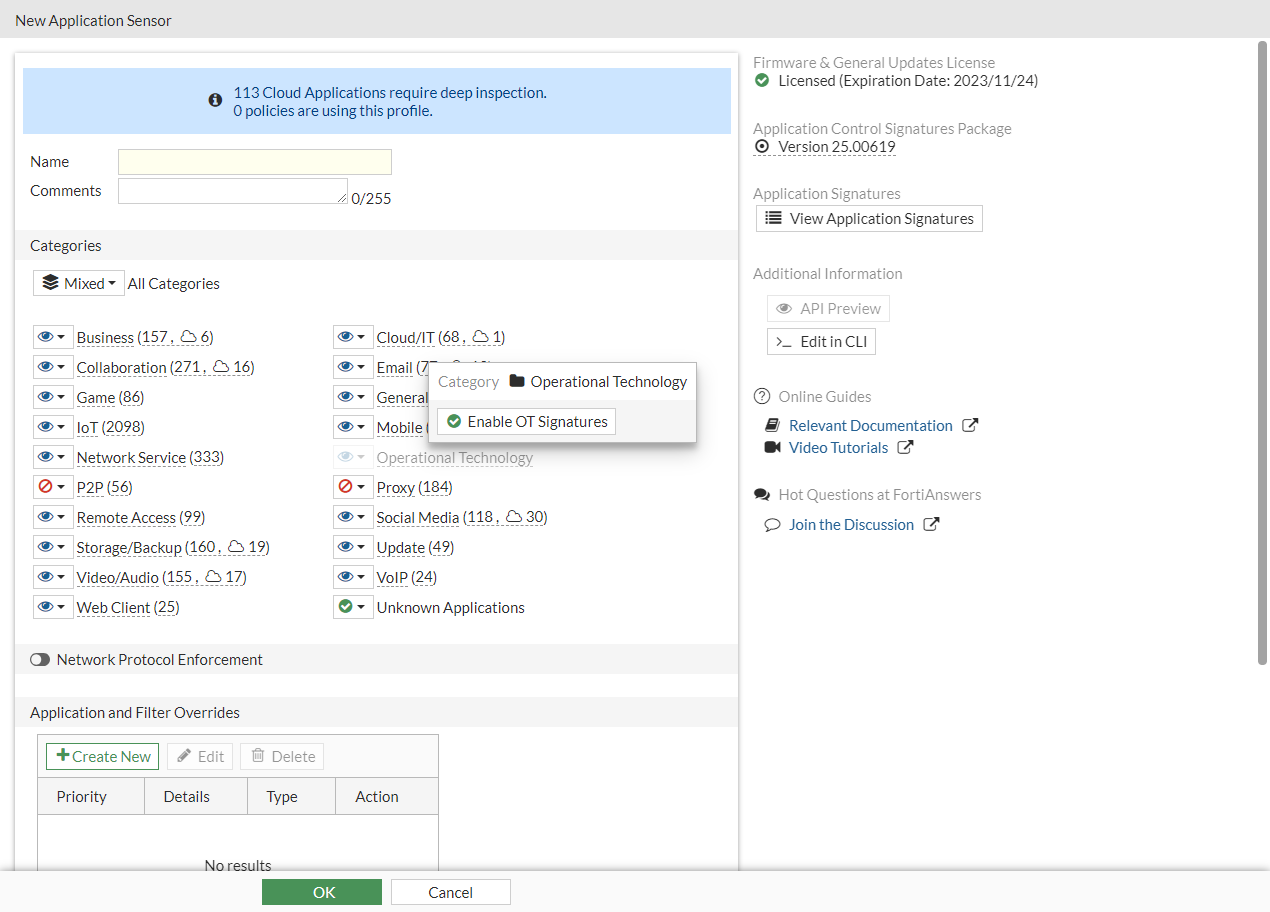

To apply the OT category to an application control sensor:
Go to Security Profiles > Application Control.
Click Create New or edit an existing profile.
If the OT category has not been enabled yet, hover over Operational Technology and click Enable OT Signatures.
The Confirm dialog opens, noting that This will enable operational technology signatures globally. Are you sure you wish to proceed? Click OK.

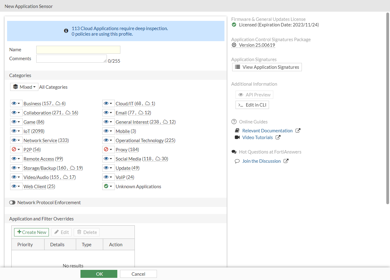

Select the action from the dropdown for the Operational Technology category.
In FortiOS 7.4.1 and later, the Industrial category is renamed to Operational Technology.
Configure the other application sensor settings as needed.

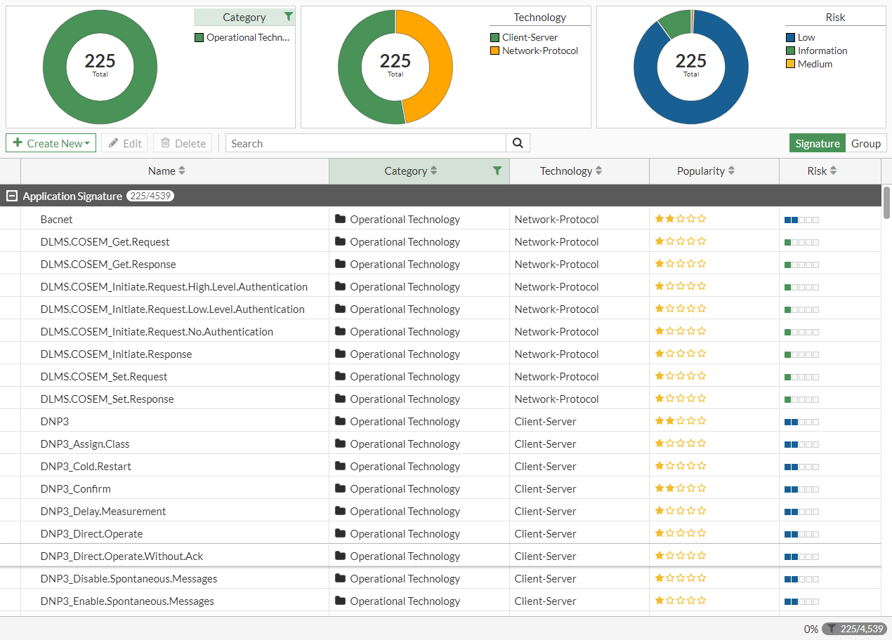

To view OT application signatures:
Go to Security Profiles > Application Signatures.
In the Category column, click the funnel icon and filter by Operational Technology, then click Apply.
