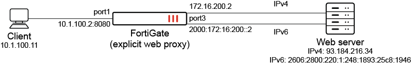

Example
In this example, a client visits a web server through a FortiGate explicit web proxy that has IPv4 and IPv6 connections to the web server (www.example.com), which can resolve to IPv4 address 93.184.216.34 and IPv6 address 2606:2800:220:1:248:1893:25c8:1946.
The configuration uses sequential connection mode, the IPv4 first protocol, and the default connection timeout (200 ms).

Example
