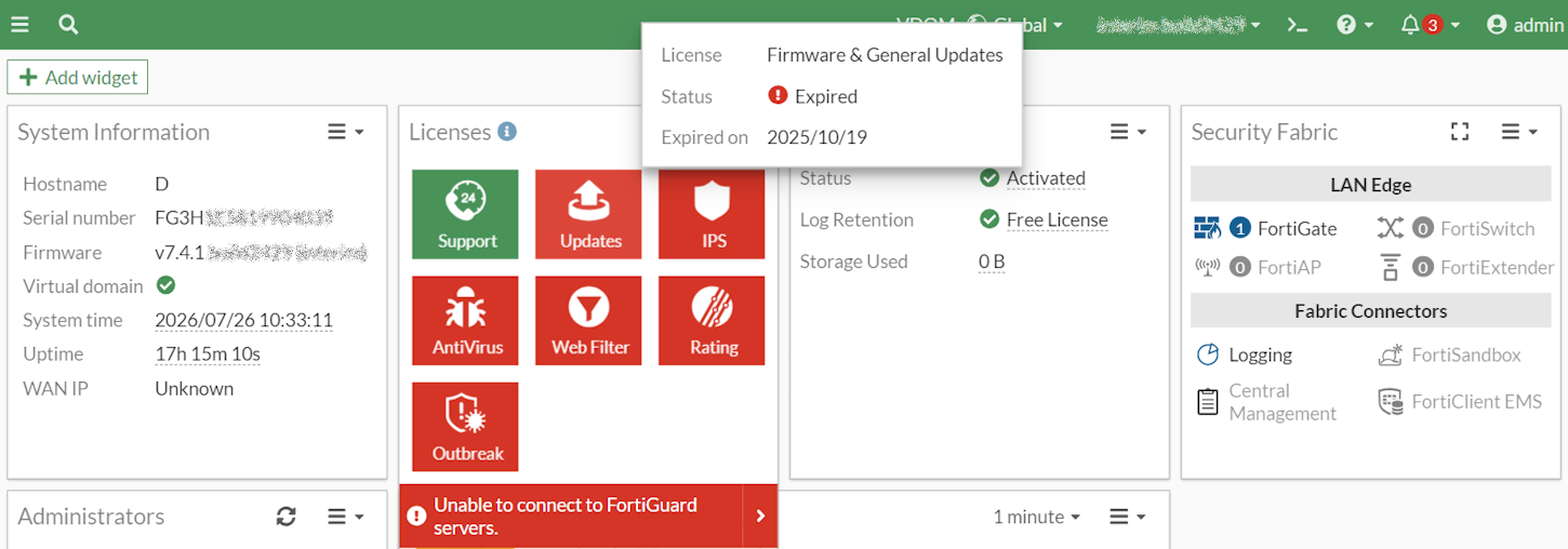

You can confirm the Firmware & General Updates (FMWR) contract expiry date in the System > FortiGuard page, by using the diagnose test update info contract | grep FMWR command or by hovering your mouse over the Updates tile in the Licenses widget in Dashboard > Status.

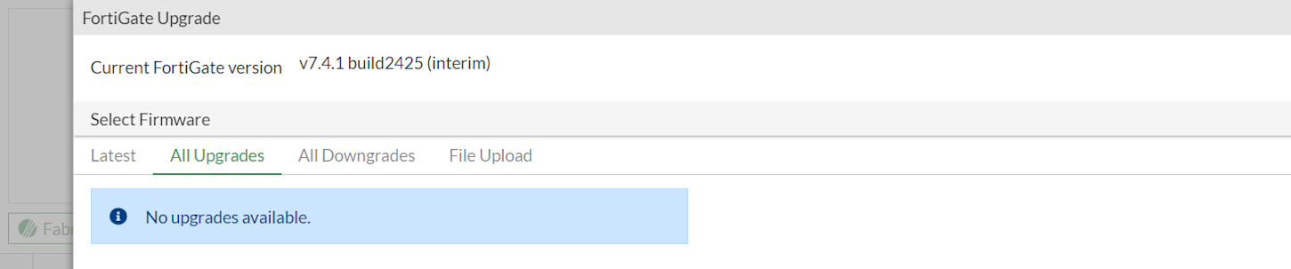

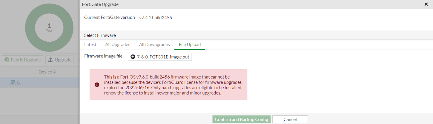

If the contract is expired, the following upgrade attempts will be blocked in the GUI System > Firmware & Registration page:
  • If a higher, major or minor version firmware is uploaded to the FortiGate, the upgrade cannot be processed and a warning will display.
    In the following example, a firmware image file is uploaded in an attempt to upgrade the FortiGate from 7.4.1 to 7.6.0. However, since the license is expired, the upgrade is denied and a warning is displayed.
  • FortiGuard upgrades will be unavailable until the support contract is renewed.

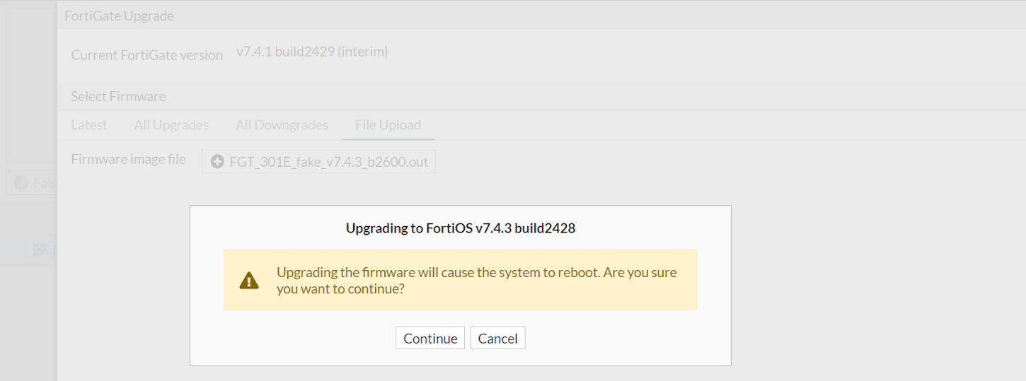

When the support contract is expired, the following action is still available in the GUI System > Firmware & Registration page:
  • The FortiGate firmware can be upgraded to a higher patch build to allow for necessary security updates.
    In the following example, a firmware image file is uploaded in an attempt to upgrade from 7.4.1 to 7.4.3. Since it is a patch release, the file is accepted and the upgrade can proceed.
