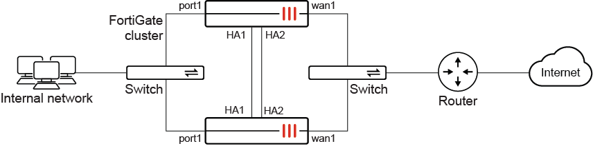

This example uses the following network topology:

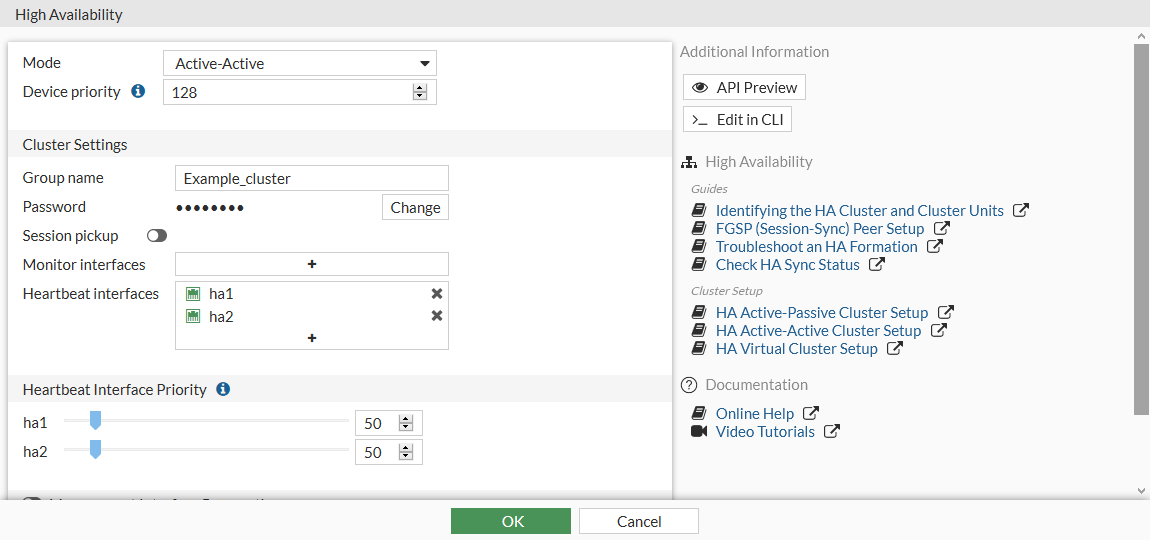

To set up an HA A-A cluster using the GUI:
- Make all the necessary connections as shown in the topology diagram.
- Log into one of the FortiGates.
- Go to System > HA and set the following options:
Mode
Active-Active
Device priority
128 or higher
Group name
Example_cluster
Heartbeat interfaces
ha1 and ha2
Except for the device priority, these settings must be the same on all FortiGates in the cluster.
The group ID can be configured in the CLI and must be the same in all HA members in order to form a cluster. The group ID can impact the definition of the virtual MAC addresses of interfaces. See Determining VMAC addresses for more details.
- Leave the remaining settings as their default values. They can be changed after the cluster is in operation.
- Click OK.
The FortiGate negotiates to establish an HA cluster. Connectivity with the FortiGate may be temporarily lost as the HA cluster negotiates and the FGCP changes the MAC addresses of the FortiGate's interfaces.
- Factory reset the other FortiGate that will be in the cluster, configure GUI access, then repeat steps 1 to 5, omitting setting the device priority, to join the cluster.
