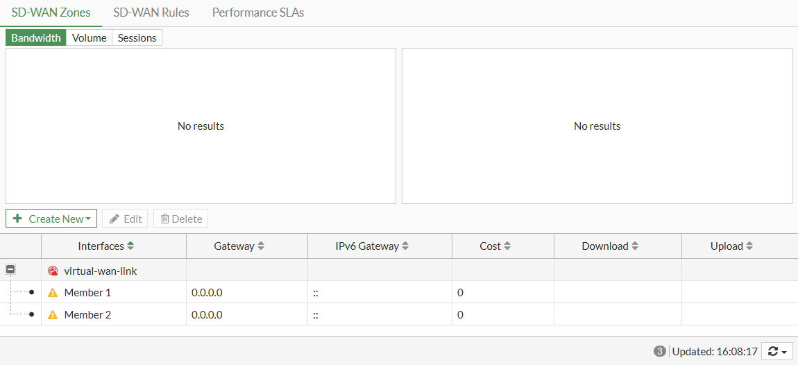

To create the SD-WAN members in the GUI:
  1. Go to Network > SD-WAN, select the SD-WAN Zones tab, and click Create New > SD-WAN Member.
  2. Leave all the settings set to their default values and click OK.
  3. Repeat the above steps to create a second member.
    The empty members are listed on the SD-WAN Zones tab.

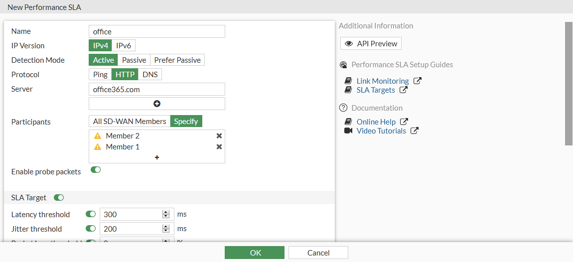

    The members are disabled until interfaces are configured, but can still be used in performance SLAs and SD-WAN rules.
To create a performance SLA in the GUI:
  1. Go to Network > SD-WAN and select the Performance SLAs tab.
  2. Click Create New.
  3. Configure the performance SLA, specifying the empty members as participants.
  4. Click OK.

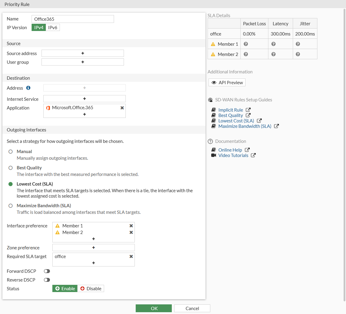

To create an SD-WAN rule in the GUI:
  1. Go to Network > SD-WAN, select the SD-WAN Rules tab, and click Create New.
  2. Configure the rule, adding both members to the Interface preference field:
  3. Click OK.

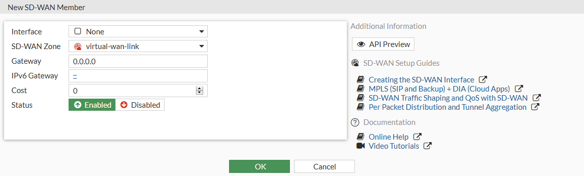

To assign interfaces to the SD-WAN members in the GUI:
  1. Go to Network > SD-WAN and select the SD-WAN Zones tab.
  2. Edit the first member
  3. Set Interface to an actual interface.
  4. Click OK.
  5. Repeat the above steps to assign an interface to the second member.

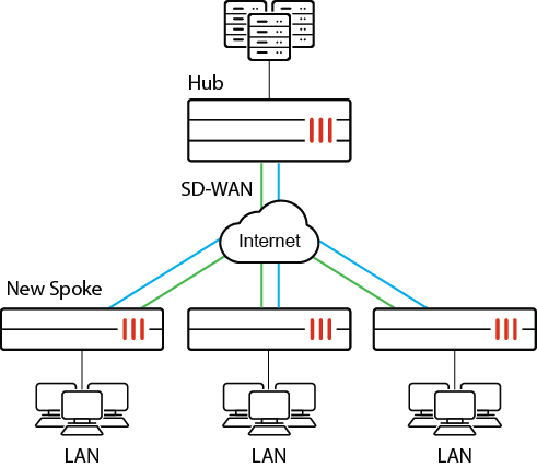

    The SD-WAN configuration can now be used in as a template for new spokes, as in Example 2.
Example 2
In this example, the configuration from Example 1 is copied onto a new FortiGate.

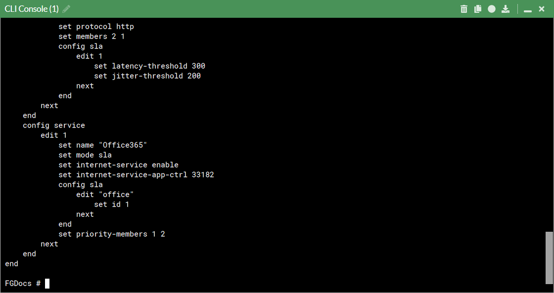

Using the CLI console and the GUI
To copy the SD-WAN configuration from the original FortiGate:
  1. Optionally, change the console screen paging setting. See Screen paging for details.
  2. Open the CLI console.
  3. If necessary, click Clear console to empty the console.
  4. Enter the following command:
    show system sdwan
  5. Either click Download and open the file in a text editor, or click Copy to clipboard and paste the content into a text editor.
  6. Edit the CLI configuration as necessary. For example, the first line that shows the show command should be deleted, and the default health checks can be removed.
  7. If required, save the CLI configuration as a text file.
