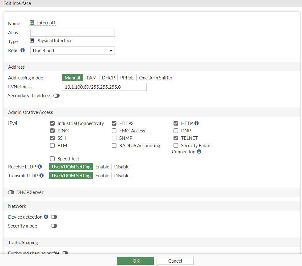

To enable Industrial Connectivity for an interface in the GUI:
  1. Go to Network > Interfaces.
  2. Click Create New > Interface, or double-click an interface to open in for editing.
  3. Set Role to Undefined or WAN
    Only internal and WAN interfaces support Industrial Connectivity administrative access.
  4. In the Administrative Access section, select Industrial Connectivity.
  5. Set the remaining options as desired, and click OK.
