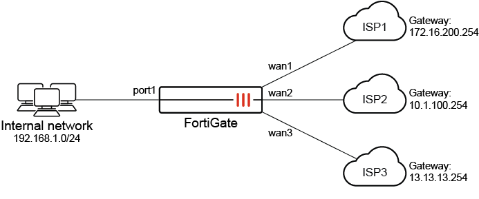

This example covers a use case where a user has multiple WAN links and wants to optimize the WAN link selection and performance while limiting the use of more expensive and bandwidth intensive interfaces, such as 5G or LTE.
In this scenario, the user has three WAN links. The goal is to balance the load between wan1 and wan2; however, wan3, which is quite costly to operate, should only be used if both wan1 and wan2 are unavailable.
This configuration involves the following steps:
  1. Configuring the SD-WAN members
  2. Configuring the manual SD-WAN rule
  3. Configuring a static route
  4. Configuring a firewall policy for SD-WAN
  5. Verifying the configuration

  1. Configure the wan1, wan2, and wan3 interfaces (see Interface settings for more details).
    1. Set the wan1 interface IP/Netmask to 172.16.200.1 255.255.255.0.
    2. Set the wan2 interface IP/Netmask to 10.1.100.1 255.255.255.0.
    3. Set the wan3 interface IP/Netmask to 13.13.13.1 255.255.255.0.

To configure the SD-WAN members in the CLI:
config system sdwan
    set status enable
    config zone
        edit "virtual-wan-link"
    config members
            set interface "wan1"
            set gateway 172.16.200.254
            set interface "wan2"
            set gateway 10.1.100.254
        edit 3
            set interface "wan3"
            set gateway 13.13.13.254
To verify the SD-WAN member status:
# diagnose sys sdwan member
Member(1): interface: wan1, flags=0x0 , gateway: 172.16.200.254, priority: 1 1024, weight: 0
Member(2): interface: wan2, flags=0x0 , gateway: 10.1.100.254, priority: 1 1024, weight: 0
Member(3): interface: wan3, flags=0x0 , gateway: 13.13.13.254, priority: 1 1024, weight: 0
