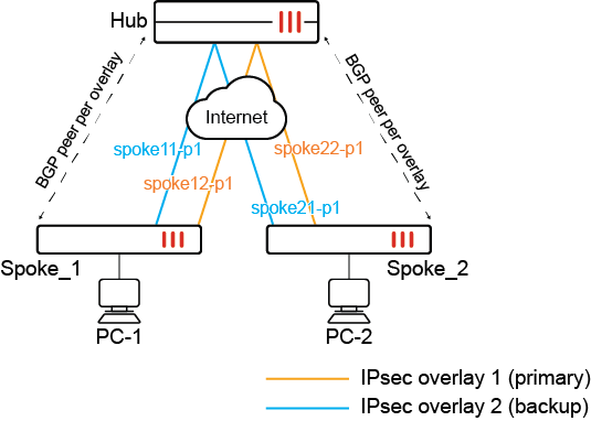

Example configuration
The following example demonstrates using the sla-stickiness option in use case 1.
After an idle timeout occurs, existing sessions remain on the spoke12-p1_0 backup shortcut tunnel. New sessions will try to create a shortcut over spoke11-p1, but will fall back to spoke12-p1_0 when it detects spoke11-p1 is out of SLA.
To configure shortcut stickiness for ADVPN shortcuts:
Configure SD-WAN on the Spoke_1 FortiGate:
config system sdwan set status enable config zone edit "virtual-wan-link" next end config members edit 1 set interface "spoke11-p1" next edit 2 set interface "spoke12-p1" next end config health-check edit "1" set server "9.0.0.1" set members 1 2 config sla edit 1 next end next end config service edit 1 set name "1" set mode sla set sla-stickiness enable set dst "all" set src "10.1.100.0" config sla edit "1" set id 1 next end set priority-members 1 2 next end end -

Send traffic from PC-1 to PC-2 to trigger the primary shortcut. Verify the diagnostics.
Run a sniffer trace:
# diagnose sniffer packet any 'host 192.168.5.44' 4 interfaces=[any] filters=[host 192.168.5.44] 14.878761 port2 in 10.1.100.22 -> 192.168.5.44: icmp: echo request 14.878905 spoke11-p1 out 10.1.100.22 -> 192.168.5.44: icmp: echo request 14.879842 spoke11-p1 in 192.168.5.44 -> 10.1.100.22: icmp: echo reply 14.880082 port2 out 192.168.5.44 -> 10.1.100.22: icmp: echo reply 15.879761 port2 in 10.1.100.22 -> 192.168.5.44: icmp: echo request 15.879882 spoke11-p1_0 out 10.1.100.22 -> 192.168.5.44: icmp: echo request 15.880433 spoke11-p1_0 in 192.168.5.44 -> 10.1.100.22: icmp: echo reply 15.880496 port2 out 192.168.5.44 -> 10.1.100.22: icmp: echo reply
The SD-WAN service rule sends traffic to the parent tunnel (spoke11-p1) initially, and then switches to the primary shortcut tunnel (spoke11-p1_0) once it is established.

Make the primary shortcut be out of SLA. The traffic will switch to the backup parent tunnel and trigger the backup shortcut. Verify the diagnostics.
# diagnose sniffer packet any 'host 192.168.5.44' 4 interfaces=[any] filters=[host 192.168.5.44] 20.588046 port2 in 10.1.100.22 -> 192.168.5.44: icmp: echo request 20.588157 spoke12-p1 out 10.1.100.22 -> 192.168.5.44: icmp: echo request 20.588791 spoke12-p1 in 192.168.5.44 -> 10.1.100.22: icmp: echo reply 20.588876 port2 out 192.168.5.44 -> 10.1.100.22: icmp: echo reply 21.589079 port2 in 10.1.100.22 -> 192.168.5.44: icmp: echo request 21.589190 spoke12-p1_0 out 10.1.100.22 -> 192.168.5.44: icmp: echo request 21.589661 spoke12-p1_0 in 192.168.5.44 -> 10.1.100.22: icmp: echo reply 21.589733 port2 out 192.168.5.44 -> 10.1.100.22: icmp: echo reply
When the primary shortcut tunnel goes out of SLA (spoke11-p1_0, alive, sla(0x0)), traffic reroutes to the backup parent tunnel (spoke12-p1) and then to the backup shortcut tunnel (spoke12-p1_0) once established.
