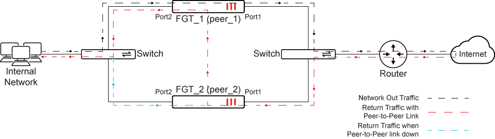

Traffic originally passes through UTM inspection over peer_1. The return traffic is routed to peer_2, where it will bounce to peer_1, the original FGSP peer for inspection.
If peer_1 becomes unavailable or unhealthy, traffic no longer bounces back to peer_1. Instead, it is failed over to peer_2 for processing.
