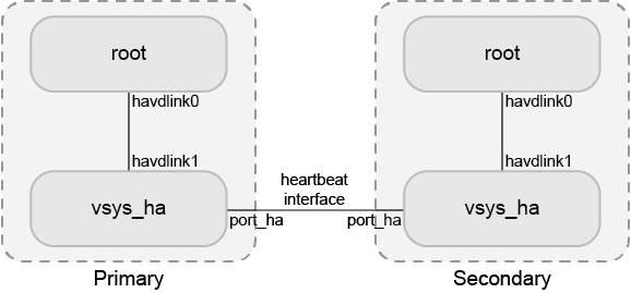

Interface IP addresses
An FGCP cluster communicates heartbeat packets using Layer 2 frames over the physical heartbeat interface, but it also communicates other synchronization traffic, logs, and locally generated traffic from subordinate devices over Layer 3 IP packets. Additional virtual interfaces are created in the hidden vsys_ha VDOM, which need to be addressed with IPv4 addresses.
The FGCP uses link-local IPv4 addresses (see RFC 3927) in the 169.254.0.x range for the virtual HA heartbeat interface (port_ha) and for the inter-VDOM link interfaces between the vsys_ha and management VDOM. When members join an HA cluster, each member's heartbeat interface (port_ha) is assigned an IP address from the range of 169.254.0.1 to 169.254.0.63/26. HA inter-VDOM link interfaces (havdlink0 and havdlink1) are assigned IP address from the range of 169.254.0.65 to 169.254.0.66/26.
The IP address that is assigned to a virtual heartbeat interface depends on the serial number priority of the member. Higher serial numbers have a higher priority, and therefore a lower serialno_prio number, for example:
# diagnose sys ha status ... FGVM08TM20002002: Secondary, serialno_prio=0, usr_priority=128, hostname=FGVM08TM20002002 FGVM08TM19003001: Primary, serialno_prio=1, usr_priority=128, hostname=FGVM08TM19003001
The member with serialno_prio=0 is assigned IP address 169.254.0.1, serialno_prio=1 is assigned 169.254.0.2, and so forth.
