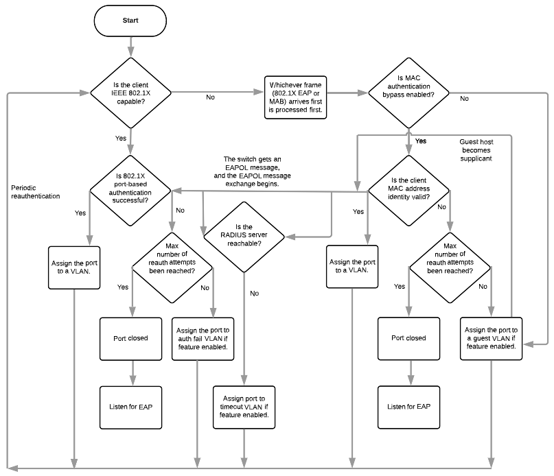

The following flowchart shows the FortiSwitch 802.1X port-based authentication with MAB enabled and with an authentication priority of auth-priority legacy:

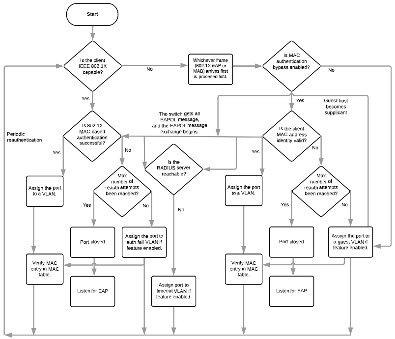

The following flowchart shows the FortiSwitch 802.1X MAC-based authentication with MAB enabled and with an authentication priority of auth-priority legacy:

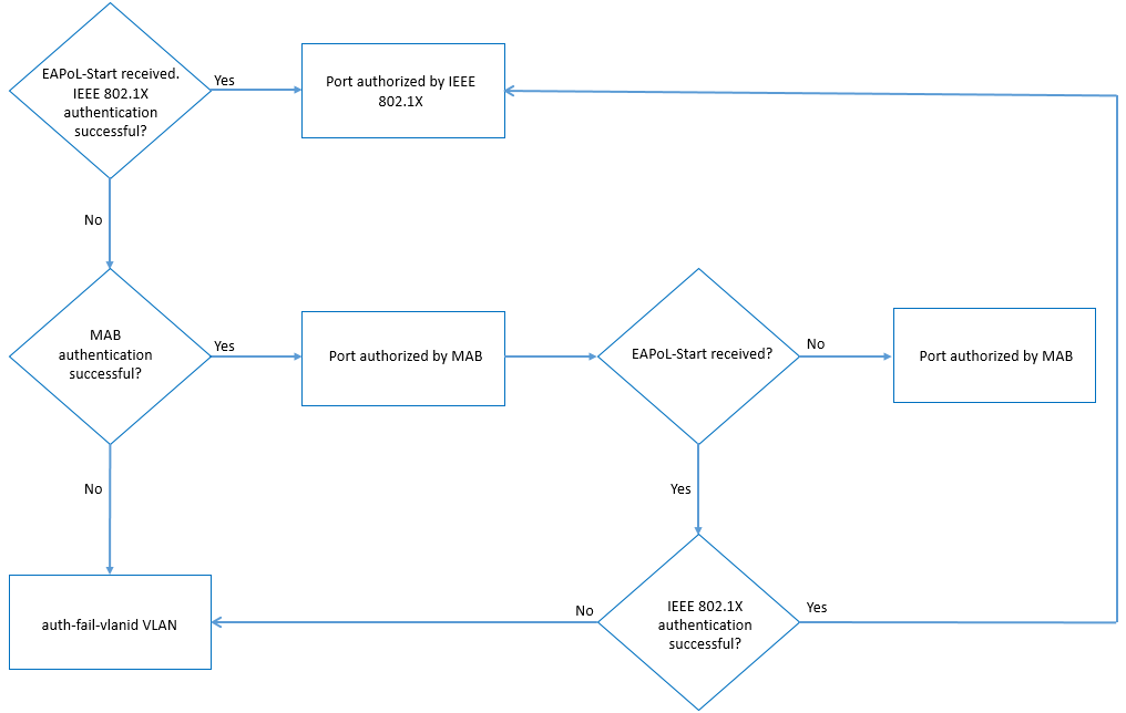

In the following flowchart, the authentication priority is dot1x-mab. If both EAP 802.1X authentication and MAB authentication fail, the user is assigned to the auth-fail-vlanid VLAN. If an EAPoL-Start packet is received after MAB authentication, the switch changes to EAP 802.1X authentication.

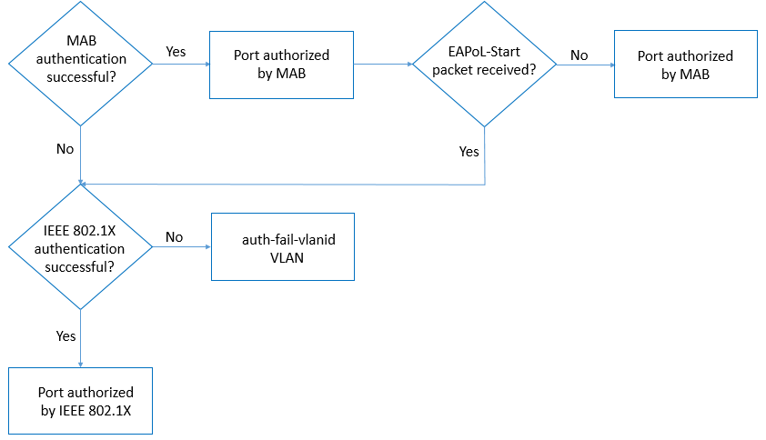

In the following flowchart, the authentication priority is mab-dot1x. If MAB authentication fails, the switch attempts EAP 802.1X authentication. If an EAPoL-Start packet is received after MAB authentication, the switch attempts EAP 802.1X authentication without any time delay or processing impact.
