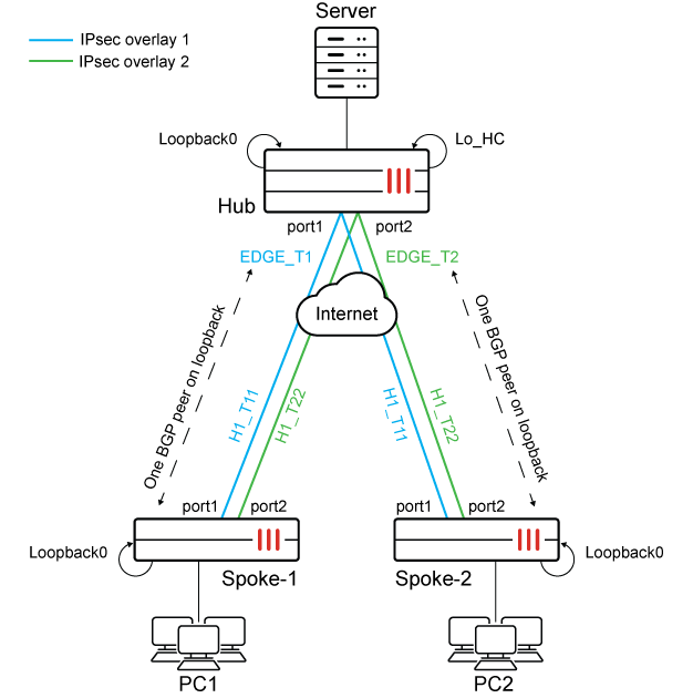

Path selection based on embedded SLA status
In this example, spokes are configured to embed the SLA status in ICMP probes, and the hub is configured to use the information. With this configuration:
  • The spoke's SLA information (packet-loss, latency, jitter, and mos) and SLA status (in SLA or out of SLA) on each overlay are embedded into ICMP probes and transported to the hub;
  • The hub sets priorities on IKE routes over different overlays based on the received SLA status on overlays
  • On the hub, BGP routes, which are used to guide hub-to-spoke traffic, rely on IKE routes to be resolved to tunnels and inherit the priorities from the IKE routes
  • The hub can steer traffic to spokes by resolved BGP routes with different inherited priorities
To embed SD-WAN SLA status and priorities in ICMP probes:

      • EDGE_T1_0 is to H1_T11 on Spoke-1, and EDGE_T1_1 is to H1_T11 on Spoke-2.
      • EDGE_T2_1 is to H1_T22 on Spoke-1, and EDGE_T1_0 is to H1_T22 on Spoke-2.

  4. After the spokes' SLA status on overlays are embedded in ICMP probes and transported to the hub, view the routing tables on the hub.
    Based on the received in-SLA status, the hub sets a predefined priority of 100 on IKE routes over EDGE_T1 and EDGE_T2. Meanwhile, recursively resolved BGP routes inherit the priorities from those IKE routes.

  5. Change the latency on Spoke-1 and Spoke-2, and view the results.
    1. On Spoke-1, increase H1_T11's latency to 60 to make it out of SLA.
    2. On Spoke-2, increase H1_T11's latency to 80 to make it out of SLA.

  6. After the hub receives the updated SLA status, run a health check on the hub and view the routing tables.
    The hub has updated the route priorities based on predefined priority settings (set priority-in-sla 100 and set priority-out-sla 200).

      For EDGE_T1, the priority changed from 100 to 200 because it is out of SLA.

      • For 10.0.3.0/24, EDGE_T2 is preferred. Priority for EDGE_T1 changed from 100 to 200.
      • For 10.0.4.0/24, EDGE_T2 is preferred. Priority for EDGE_T1 changed from 30 to 40.

The SD-WAN topology with ADVPN and BGP neighbor on loopback is used for the following two examples:

Speed test rerouting based on embedded SLA status
When spoke-initiated speed tests are enabled for this configuration, the out-of SLA status is used by the hub to choose other routes during the speed test.
To configure speed tests:
  1. On the hub, enable speed tests and allow them on the underlays and overlays.
    1. Enable speed tests:
      config system global
          set speedtest-server enable
          set speedtestd-ctrl-port 6000
          set speedtestd-server-port 7000
    2. Allow speed tests on the underlay:

  2. On Spoke-1, schedule speed tests:
    config system speed-test-schedule edit "H1_T11" set mode TCP set schedules "speed-test" set dynamic-server enable set ctrl-port 6000 set server-port 7000 set update-shaper remote next edit "H1_T22" set mode UDP set schedules "speed-test" set dynamic-server enable set ctrl-port 6000 set server-port 7000 set update-shaper remote next end
Before starting the speed test on Spoke-1, route priorities are based on the received in-SLA status on both H1_T11 and H1_T22
DC1_A_FGT (root) (Interim)# get router info routing-table  bgp
Routing table for VRF=0
B       10.0.3.0/24 [200/0] via 172.31.0.65 (recursive via EDGE_T2 tunnel 172.31.0.65 [100]), 00:24:14
                                            (recursive via EDGE_T1 tunnel 10.0.0.20 [100]), 00:24:14, [1/0]
While the speed test is running on H1_T11 of Spoke-1, Spoke-1 will constantly embed NOKstatus into probes on H1_T11 and send them to the hub. Then the Hub updates route priorities accordingly and detours hub-to-spoke traffic to H1_T22 to avoid the impact on speed test of H1_T11. EDGE_T2 is preferred, and the EDGE_T1 priority changed from 100 to 200.
B       10.0.3.0/24 [200/0] via 172.31.0.65 (recursive via EDGE_T2 tunnel 172.31.0.65 [100]), 00:04:42
                                            (recursive via EDGE_T1 tunnel 10.0.0.20 [200]), 00:04:42, [1/0]
During the speed test on H1_T22 of Spoke-1, Spoke-1 constantly embeds NOK status (out of SLA status) into probes on H1_T22 and sends them to the hub. Then the Hub updates route priorities accordingly and detours hub-to-spoke traffic to H1_T11 to avoid the impact on speed test of H1_T22. EDGE_T1 is preferred, and the EDGE_T2 priority changed from 100 to 200.
B       10.0.3.0/24 [200/0] via 172.31.0.65 (recursive via EDGE_T1 tunnel 10.0.0.20 [100]), 00:00:05
                                            (recursive via EDGE_T2 tunnel 172.31.0.65 [200]), 00:00:05, [1/0]
