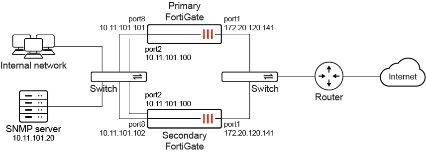

The configuration examples below will use the following topology:
Two FortiGate units are already operating in a cluster. On each unit, port8 is connected to the internal network through a switch and configured as an out-of-band reserved management interface.
Configuration changes to the reserved management interface are not synchronized to other cluster units.

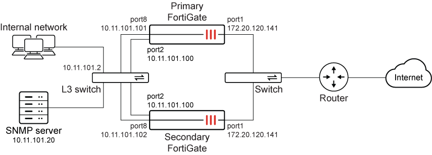

Administrative access and default route for HA management interface
To configure the primary unit's reserved management interface, configure an IP address and management access on port8. Then, configure the necessary HA settings to enable the HA reserved management interface and its route. To configure the secondary unit's reserved management interface, access the unit's CLI through the primary unit, and configure an IP address, management access on port8, and the necessary HA settings. Configuration changes to the reserved management interface are not synchronized to other cluster units.
To configure the primary unit reserved management interface to allow HTTPS, SSH, and ICMP access:
  1. From a computer on the internal network, connect to the CLI at 10.11.101.100 on port2.
  2. Change the port8 IP address and management access:
    config system interface
        edit port8
            set ip 10.11.101.101/24
            set allowaccess https ping ssh
  3. Configure the HA settings for the HA reserved management interface by defining a default route to route to the gateway 10.11.101.2:
    config system ha
        set ha-mgmt-status enable
        config ha-mgmt-interfaces
                set interface port8
                set gateway 10.11.101.2
    You can now log into the primary unit's GUI by browsing to https://10.11.101.101. You can also log into the primary unit's CLI by using an SSH client to connect to 10.11.101.101.
        edit port8
    config system ha
                set interface port8
To configure secondary unit reserved management interfaces to allow HTTPS, SSH, and ICMP access:
  1. From a computer on the internal network, connect to the primary unit's CLI.
  2. Connect to the secondary unit with the following command:
    execute ha manage <unit id> <username> <password>
  3. Change the port8 IP address and management access:
        edit port8
            set ip 10.11.101.102/24
    exit
  4. Configure the HA settings for the HA reserved management interface by defining a default route to route to the gateway 10.11.101.2:
    config system ha
                set interface port8
    You can now log into the secondary unit's GUI by browsing to https://10.11.101.102. You can also log into the secondary unit's CLI by using an SSH client to connect to 10.11.101.102.
SNMP monitoring
The SNMP server can get status information from the cluster members. To use the reserved management interfaces, you must add at least one HA direct management host to an SNMP community. If the SNMP configuration includes SNMP users with user names and passwords, HA direct management must be enabled for the users.
To configure the cluster for SNMP management using the reserved management interfaces in the CLI:
  1. Allow SNMP on port8 on both primary and secondary units:
        edit port8
            append allowaccess snmp
  2. Add an SNMP community with a host for the reserved management interface of each cluster member. The host includes the IP address of the SNMP server.
    config system snmp community
            set name "Community"
            config hosts
                    set ip 10.11.101.20 255.255.255.255
                    set ha-direct enable
    Enabling ha-direct in a non-HA environment will make SNMP unusable.
  3. Add an SNMP user for the reserved management interface:
    config system snmp user
        edit "1"
            set notify-hosts 10.11.101.20
The SNMP configuration is synchronized to all cluster units.
To get CPU, memory, and network usage information from the SNMP manager for each cluster unit using the reserved management IP addresses:
  1. Connect to the SNMP manager CLI.
  2. Get resource usage information for the primary unit using the MIB fields:
    snmpget -v2c -c Community 10.11.101.101 fgHaStatsCpuUsage
    snmpget -v2c -c Community 10.11.101.101 fgHaStatsMemUsage
    snmpget -v2c -c Community 10.11.101.101 fgHaStatsNetUsage
  3. Get resource usage information for the primary unit using the OIDs:
    snmpget -v2c -c Community 10.11.101.101 1.3.6.1.4.1.12356.101.13.2.1.1.3.1
    snmpget -v2c -c Community 10.11.101.101 1.3.6.1.4.1.12356.101.13.2.1.1.4.1
    snmpget -v2c -c Community 10.11.101.101 1.3.6.1.4.1.12356.101.13.2.1.1.5.1
  4. Get resource usage information for the secondary unit using the MIB fields:
    snmpget -v2c -c Community 10.11.101.102 fgHaStatsCpuUsage
    snmpget -v2c -c Community 10.11.101.102 fgHaStatsMemUsage
    snmpget -v2c -c Community 10.11.101.102 fgHaStatsNetUsage
  5. Get resource usage information for the primary unit using the OIDs:
    snmpget -v2c -c Community 10.11.101.102 1.3.6.1.4.1.12356.101.13.2.1.1.3.1
    snmpget -v2c -c Community 10.11.101.102 1.3.6.1.4.1.12356.101.13.2.1.1.4.1
    snmpget -v2c -c Community 10.11.101.102 1.3.6.1.4.1.12356.101.13.2.1.1.5.1
