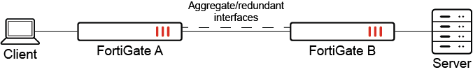

When an aggregate or redundant interface goes down, the corresponding fail-alert interface changes to down. When an aggregate or redundant interface comes up, the corresponding fail-alert interface changes to up.
Fail-detect for aggregate and redundant interfaces can be configured using the CLI.
To configure an aggregate interface so that port3 goes down with it:
config system interface
    edit "agg1"
        set vdom "root"
        set fail-detect enable
        set fail-alert-method link-down
        set fail-alert-interfaces "port3"
        set type aggregate
        set member "port1" "port2"
To configure a redundant interface so that port4 goes down with it:
    edit "red1"
        set vdom "root"
        set fail-alert-interfaces "port4"
        set type redundant
