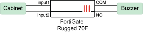

FortiGate Rugged 70G, 70F, 70F-3G4G include a general purpose input output (GPIO) module, also known as a digital I/O (DIO) module. This module activates a digital output when triggered by a change in any digital input. For example, the digital input can be connected to a cabinet door to monitor the open/close status or low/high voltage status, and the output can be connected to a buzzer. When the DIO module detects a change from open to closed or a voltage change from low to high, it triggers the buzzer.

In this example, a FortiGate Rugged 70F is configured to monitor the open/close and low/high voltage status of a cabinet door, and the output is connected to a buzzer. When the status of the cabinet door changes, FortiGate triggers the buzzer
